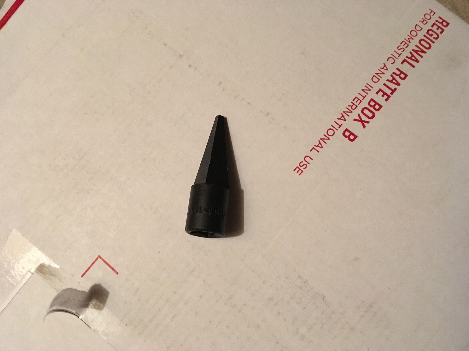

Here’s what the piston looks like.

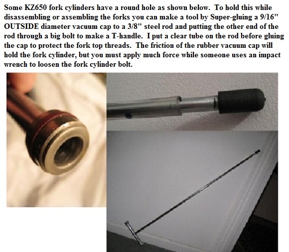

That looks like the fork cylinder on my 1977 KZ650-C1. Here's what I did so I could remove it and then torque it properly when putting it back together...........

Thanks 650ed, I used a bit of hillbilly engineering and got things torqued properly. A broomstick and a ratchet strap worked well, on to the brake calipers I go!

Put the fork completely together, compress it, then tighten the damper bolt. If you have a 3/8" impact you can just bump it tight with that.

I have an old octagon pry bar that is tapered on one end I had dug up in Aspen Colorado that had been buried about 40- 50 years. I cleaned it up and the rust pits are a perfect grip for rebuilding forks.
