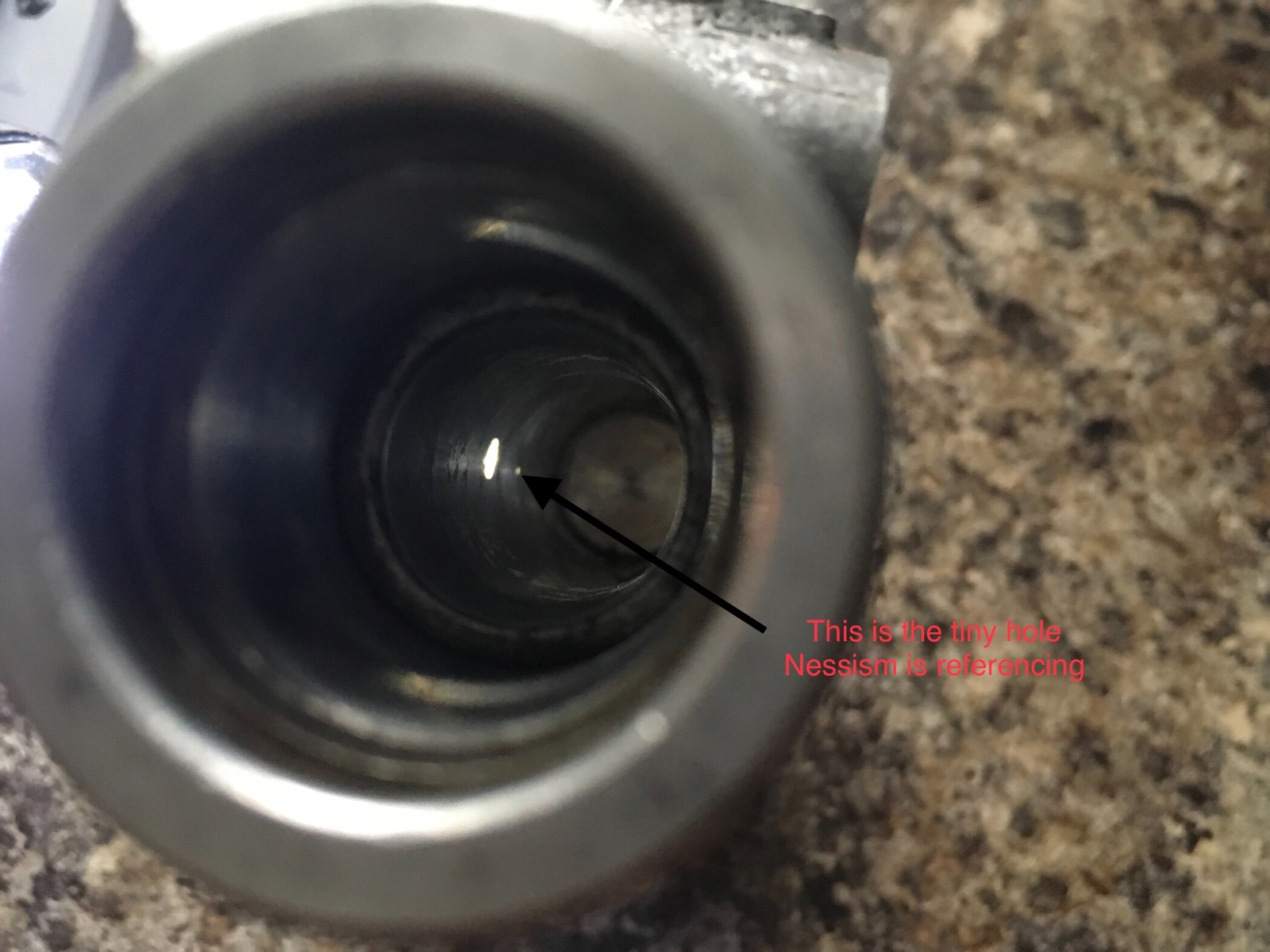

sounds like the small return bleed hole in the mc is plugged, keeping the pressurized fluid from returning from the caliper

I don't see a bleed hole anywhere.

Re: 1984 GPZ550 rear brake stuck
28 Jun 2020 15:18
This is the tiny hole that allows pressure to be released and allows the caliper to back off a smidge and not drag
