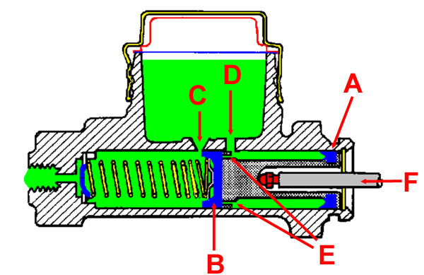

Just took lines apart and master cylinder too, it all looks good including piston/gaskets etc but
the weird thing is that if I take the master banjo off the liquid stays in the cylinder, won´t even be
pushed out with the handle. Does it need a pressurised system to work?
In that case only way is to either draw liquid down with a pump from bleeders or push it up bavkwards.
How do you guys fill an empty system?

10 Jun 2020 04:01Will do that again properly with some air, also someone said the gaskets are prone to act up
and block the pumping worst case... maybe rebuild time...
