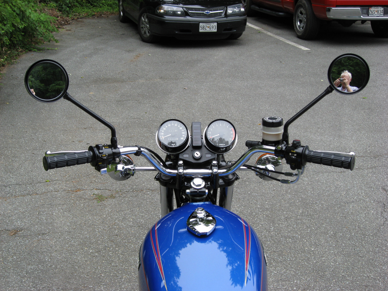

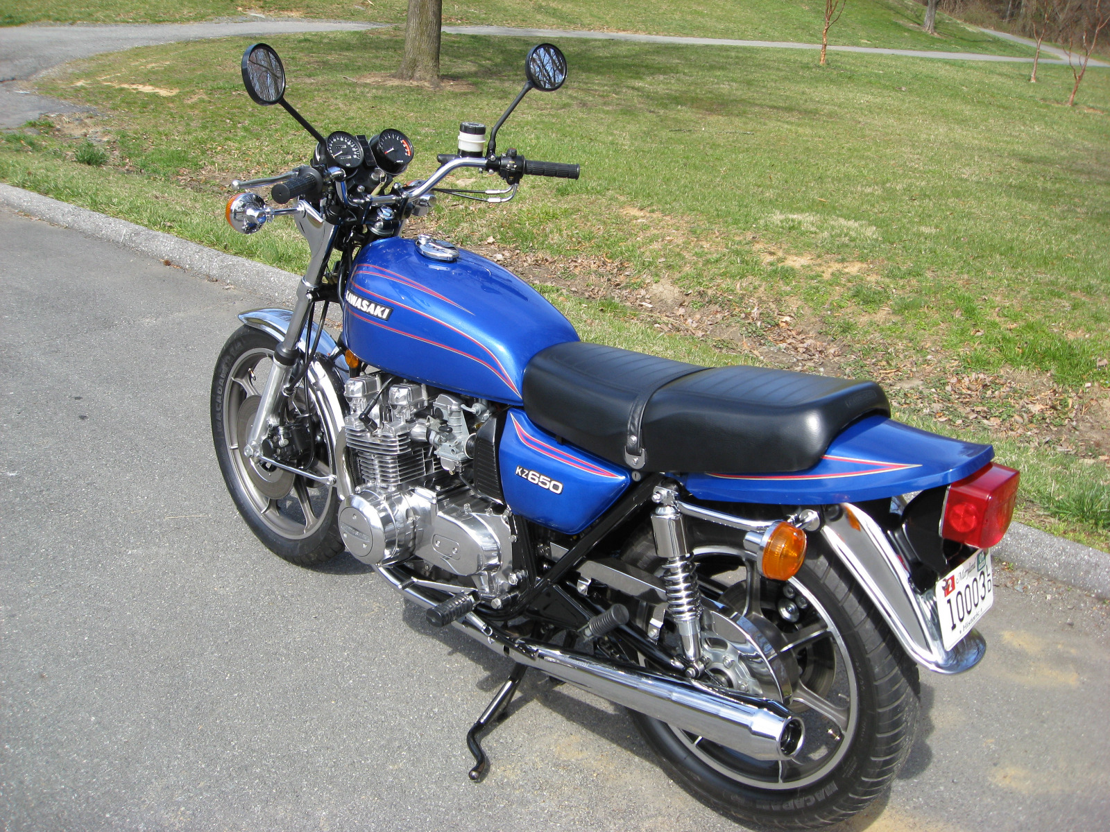

Pic below is my 650-CSR w European bars. The stock master cylinder was tilted but worked fine; then the piston started leaking. So then I installed a Honda CBR500 Fr brake mc. It's also tiled but in the other direction since it has a straight handlebar mount, but it also works fine. I originally replaced the stock bars with Flanders BMW Med Tall Street bars which are kind of like Ltd bars, but the hands are more forward & wider >> they were great around town & at lower highway speeds; but at higher speeds, not so much.

Cramped is the word. The stock 650-CSR handlebars jammed my elbows into my sides & were especially uncomfortable when doing low speed sharp turns. The med tall street bars were a great transition. most of the riding during my refurb was around town & those bars were super, plus the mc & cables didn't really need to be changed.
