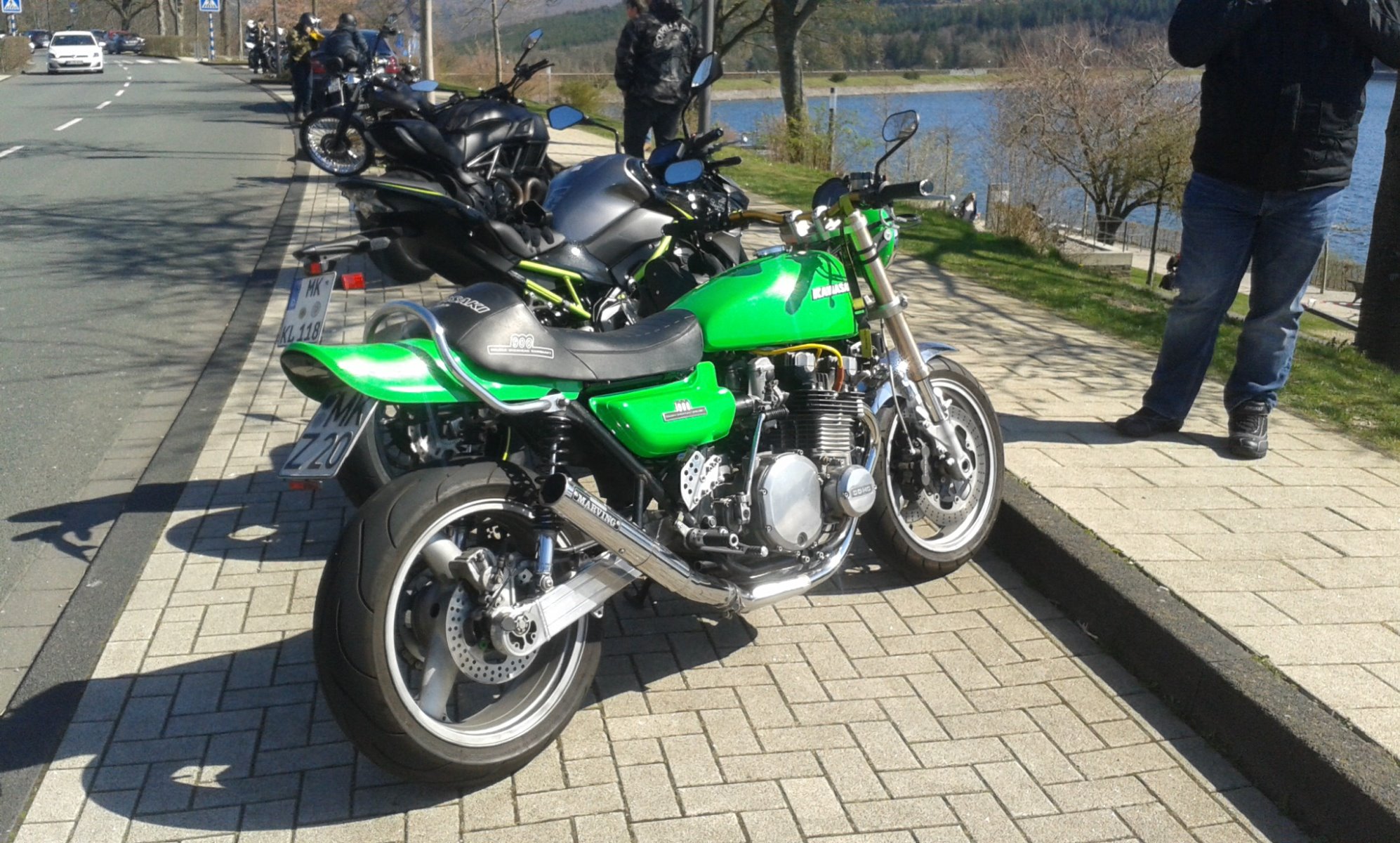

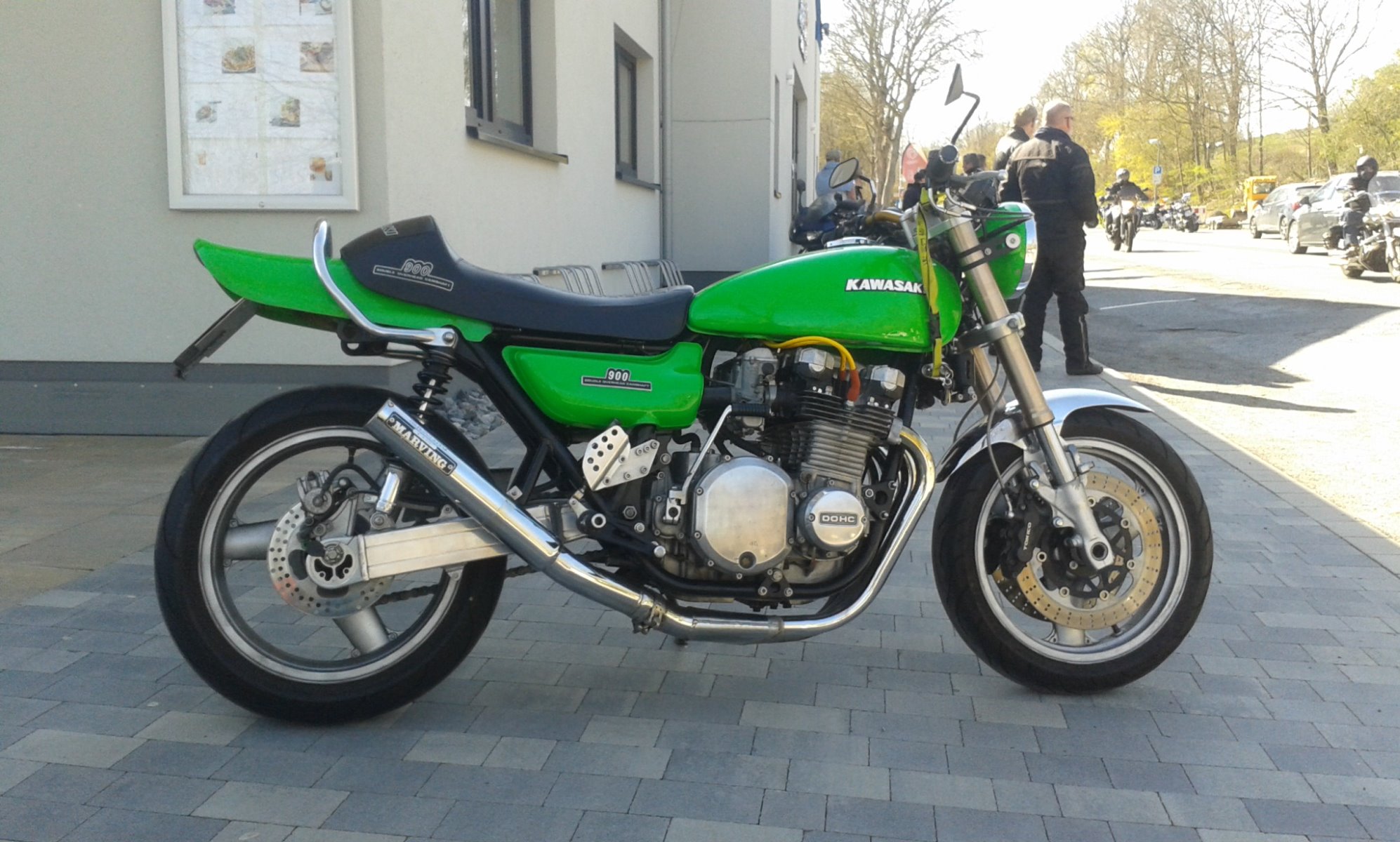

What´s your swing arm type and wheel/tire/chain size Setup?
I ride a 630 chain on a 14 mm off-set front/rear 15-35 with 5,50 x 17 wheel (ZX9R) with 180 tire. So what´s your Problem?
