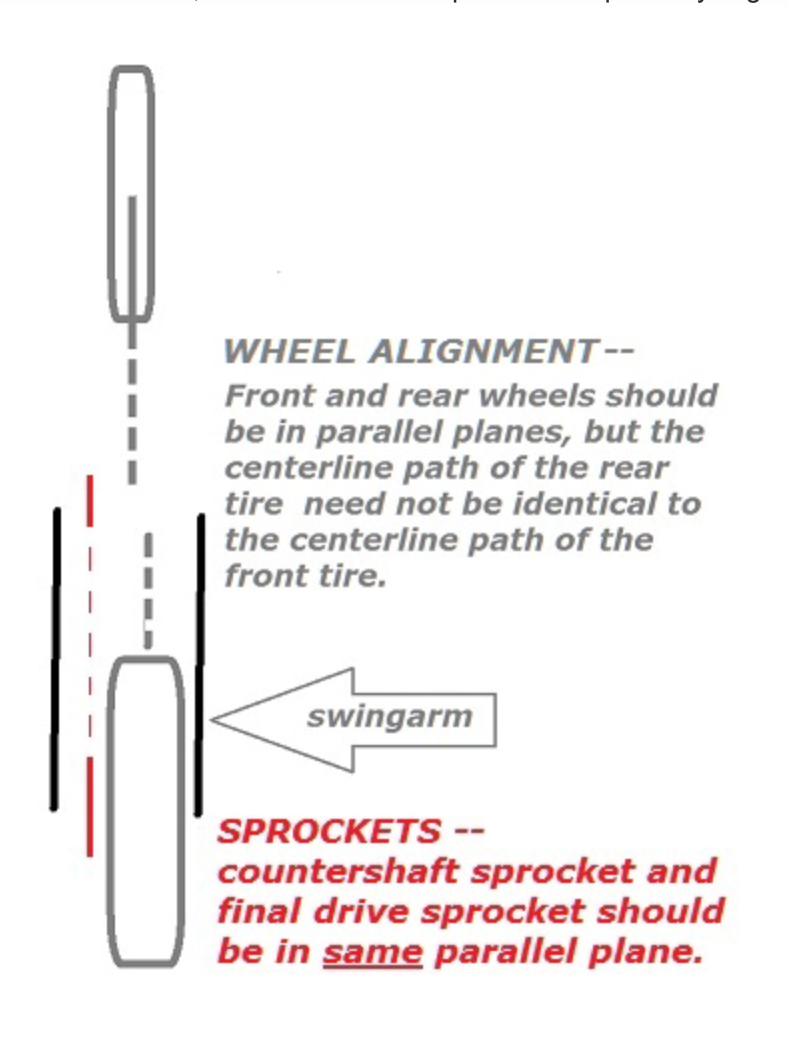

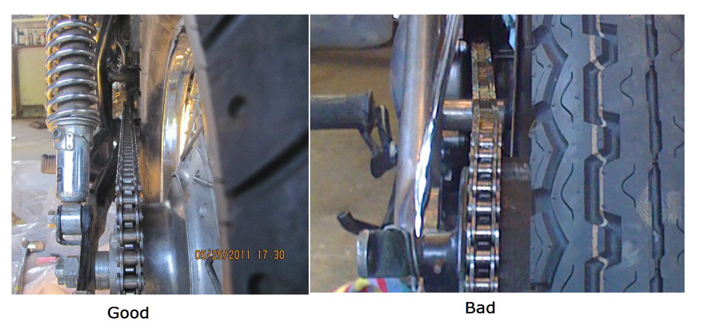

Re: 1981 KZ 440 LTD Belt Drive (late model) Belt Squeaking
31 May 2020 12:06
I can’t take credit for these screen shots, they are from another member “Patton”
Belt alignment is made by adjusting the rear axle adjusters.

I found the belt was looser than spec so I tightened the belt and (attempted to) fix the rear alignment using the belt adjusting bolts.
Initially, the left side of the front wheel measured 2/16th of an inch from the left edge of the rear wheel, and the right side of the front wheel was 1-4/16th inches away from the right edge of the rear wheel. I got it to 12/16ths on the left and 11.5/16ths on the right by adjusting the belt adjusting bolts. I also ended up tightening the belt to spec.
The ride around the block didn't make any noise. I did notice that with the tighter belt, the rear wheel is a little more difficult to spin by hand. Also, there is now a pull to the left side when riding no hands. Do you think this may be from the tires being worn non-uniformly from being out of alignment? I don't see a bend to the belt like in the photos (but honestly, I didn't see a bend before I adjusted the alignment, so I think bends are not that obvious on the belt drive).
31 May 2020 17:33
Now that you have the belt aligned, look at the notch on the swinarm and compair them from the right to the left. They should be on the same alignment marks. That will confirm your alignment. As for the pull it could be a bad wear pattern on the out of alignment wheel. You should be able to see the wear pattern on the tire. Look for feathered edges. I’d say if the noise is gone you’ve corrected the problem. Cautiously ride the bike a while and see if the pull goes away. Use extreme caution and avoid any wet roads or rain. If the tire is worn it could be a very greasy ride. Give it time to correct
