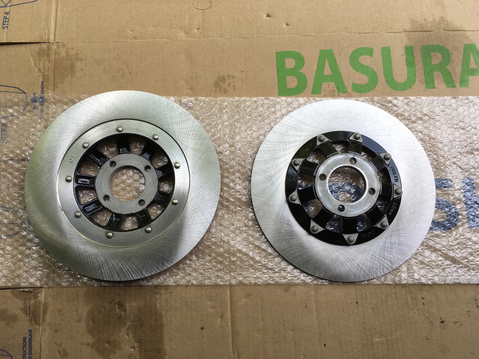

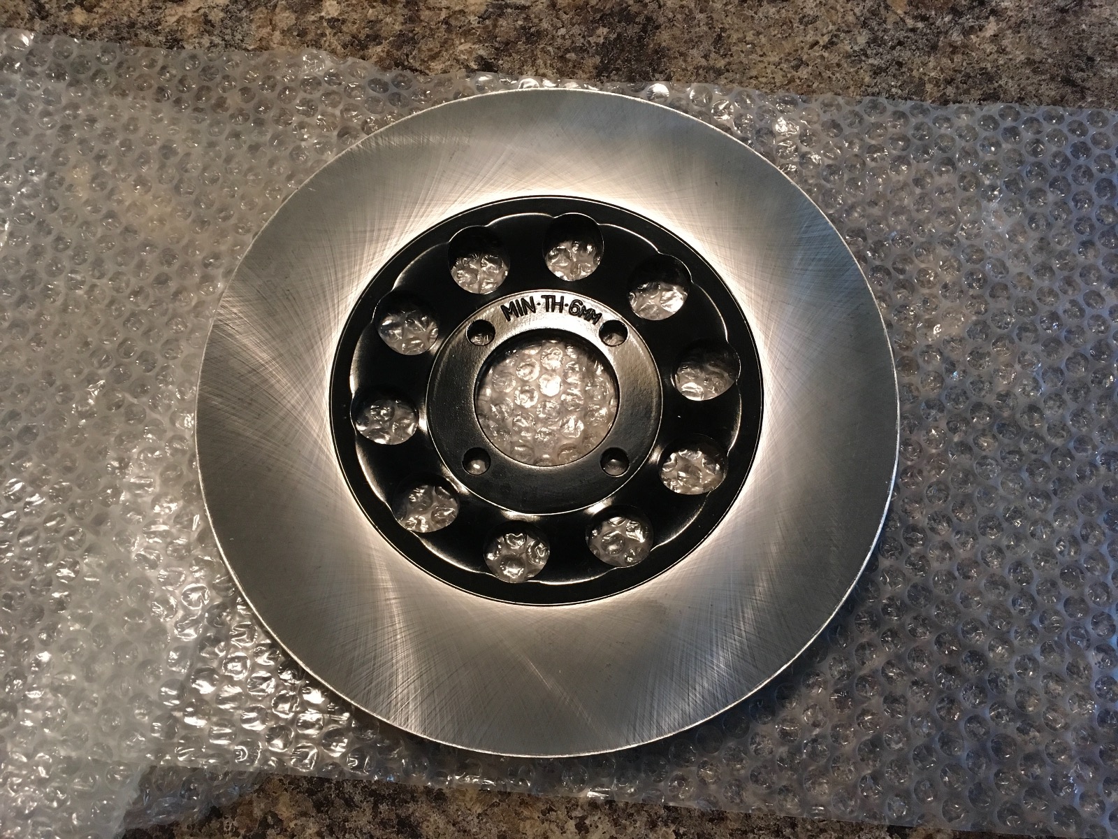

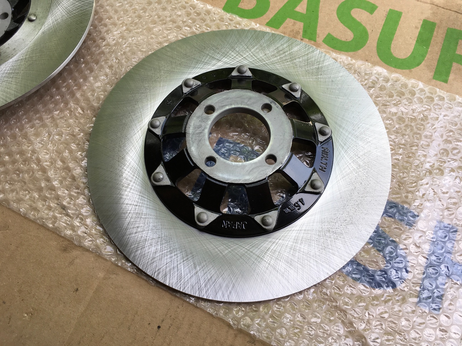

29 May 2020 13:23650ed wrote: Are you replacing the discs because of their condition? If so, you may want to consider having them properly resurfaced (see link below). It would be MUCH cheaper than buying new discs. Ed
truedisk.net/
+1 on this I just had truedisk do one rear for my ‘78 1000ltd and two for my ‘76 900 project. Quality job and I know the brakes will be far superior the a used disc.
