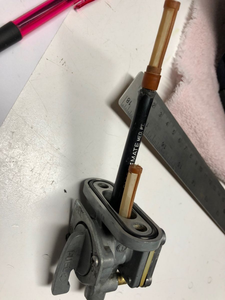

Hi guys, I have a petcock that the PO jimmy rigged the filter screen (see picture).
1) Does anyone have or know where to source the filter screen for the petcock?
I saw a picture of the petcock for a 2005 KZ1000POlice model. It looks exactly like the one from my 81.
2) Does anyone have a compatibility chart to show what petcocks will fit my 81 KZ1100 shaft?
3) Can someone with a 03 to 05 KZ1000Police model measure the bolt hole spacing for the Fuel Valve AKA petcock? Mine measures 44mm.
Thanks in Advance for your advice and help,
Scott Z

Here is a fitment list. I was a little surprised that it is not the same part for all of the KZ1000 and 1100 models from 1981 onward. I wonder whatt the difference is. I do not know of a source for just the filter screen.

Thanks, Yes, the part # is 51023-1174 but hey are currently unavailable.
The part # for the new one I saw listed on ebay is 51203-1375 for an 02 to 05 KZ1000Police. It looks exactly like the one from my 81. so I was wondering if anyone has compiled compatibility lists to use newer parts for unavailable ones.

This isn't going to be much help, but I was looking for a screen for my ZN1300 a couple of years ago (not sure if it's the same as the one your tap should have but it looks like it would be very close). In any case, I wasn't having any luck, then at a swap meeting I found a guy who had a box of tank filters and I found one that fit my tap perfectly. The screen was for a different bike and the guy sadly had no idea what it was from. The point is, they are out there - but finding them is the problem.

Thanks CB900f, That looks like what I need to find. The dimensions you show are similar to my petcock. As you can see in my pic the PO jimmy rigged a Papermate pen body to work. Unfortunately the reserve screen is torn so essentially useless. I may be forced to reuse my fuel petcock as is. It does work. An in line fuel filter will be needed.

If your 1100 also has 44mm spacing, I don't know why any other 1000/1100 petcock would not work.

Z1E has one that fits them all.
www.z1enterprises.com/petcock-kz1000k44-...0-kz650h-kz750h.html
They also list a couple for Suzukis with 44mm spacing for less money, and I bet the just might work, too.

KZ1000P petcock. I think the bolt hole spacing is 44mm. New oem are still available. 51023-1375
It's the same one listed at Z1Ent linked by TexasKZ. The partzilla pic doesn't show the screen, but I'm pretty sure it's included.

Thanks for the input guys. I have ordered a Kawasaki 51023-1375 for the 02 to 05 KZ1000Police model. I am waiting for Partzilla to deliver but they seem to be dragging their feet.
