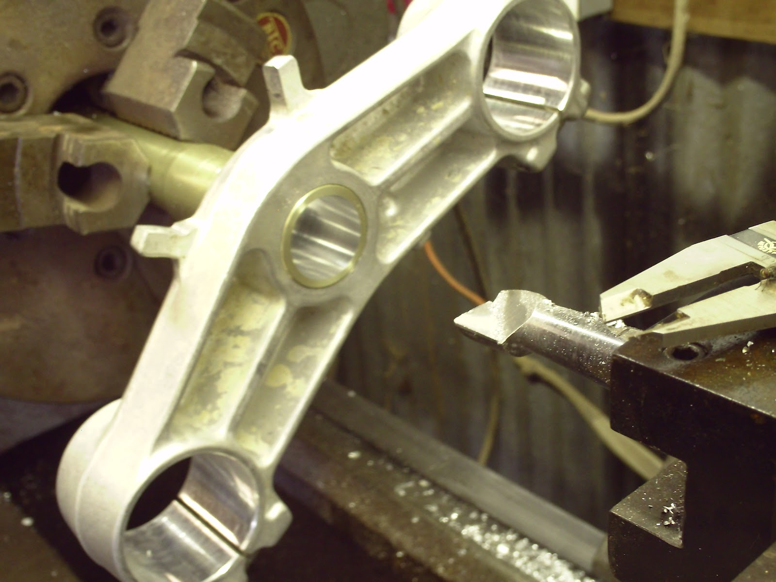

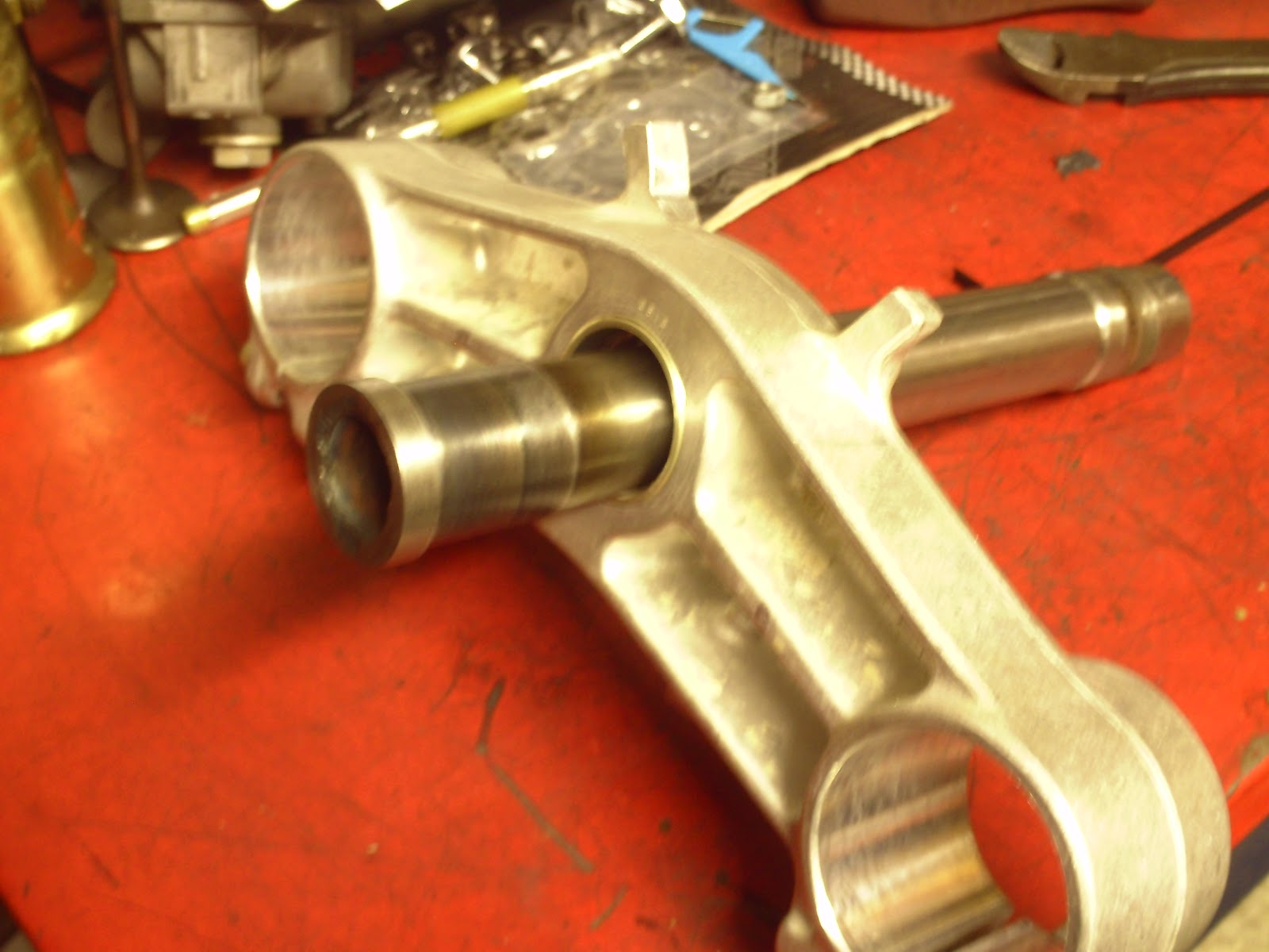

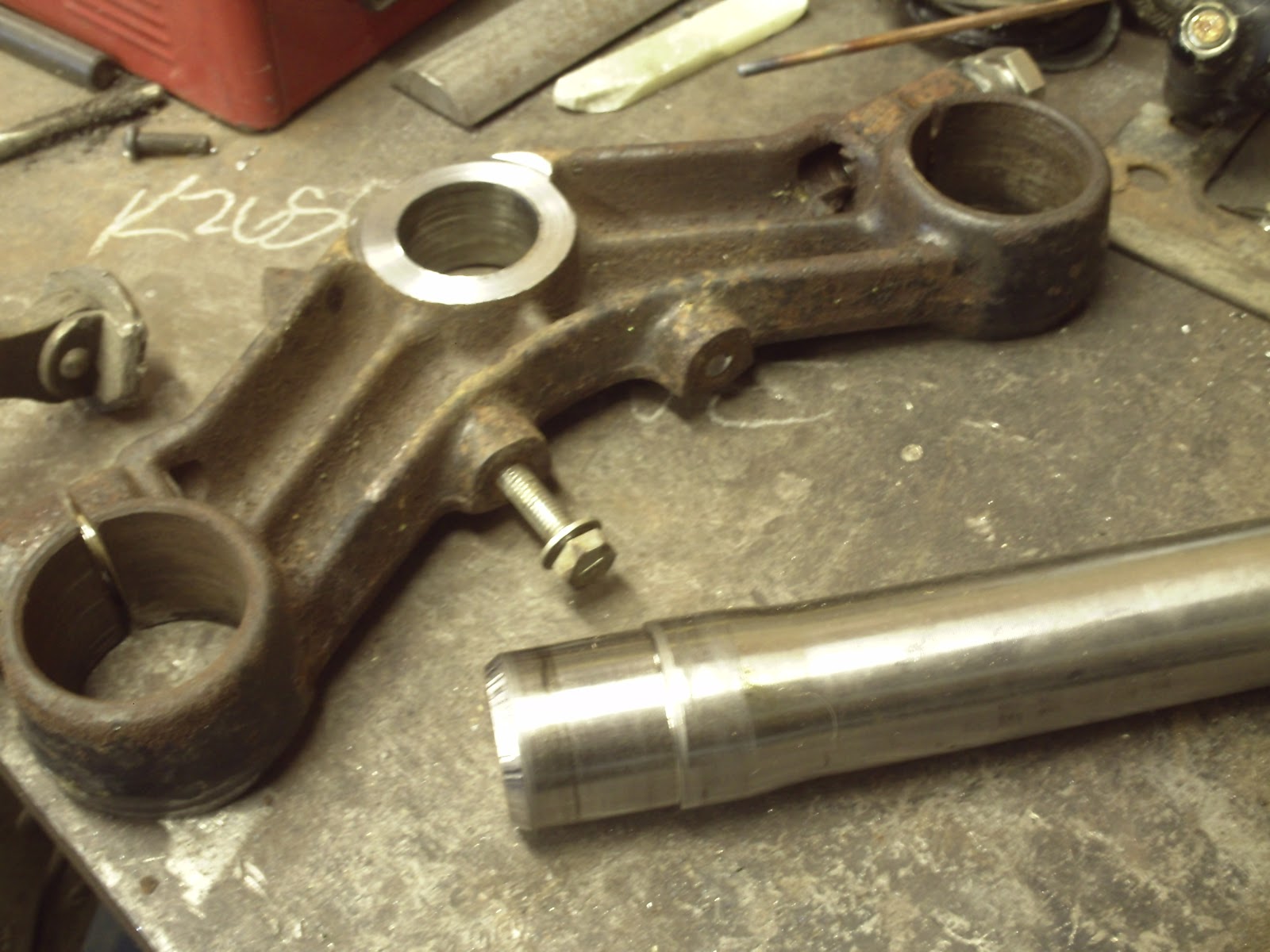

A new front end conversations needs the parts from zx6r/636 upper and lower triple tree.
Only your stock steering stem has to removed and modified to fit into the new lower triple tree.
Try to search this Forum for "Old Man Rock ZX-636 Front End Conversion".
Thanks goes to member blackbanshee for his additionally pics of his great metal working skills .

Is the donor steering stem too short? or too long or what? If it's too long, a machine shop might be able to redo it by cutting it to the correct length & machining new threads.

My understanding is the KZ1100 stem is to wide to fit it on the zx6r/zx636 lower tree. so basically you need someone who can machine down the original kz1100 stem or get a new steam that fit the new lower tree

cognito makes very nice stuff that conversion stem should be just what you need.
