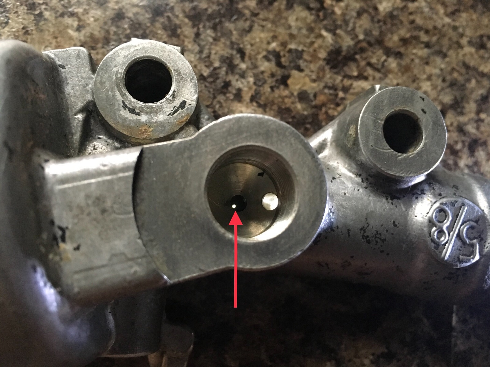

There is a super tiny hole in the master wall which must be open in order for fluid to reach the pumping chamber properly. Very good chance yours is plugged.
It's good practice to prime the master manually by filling the pumping chamber and testing the unit on the bench. Sometimes the lack of pumping action is due to a bubble blocking fluid flow filling the chamber.
Be sure to replace your brake line and rebuild the caliper at the same time. There is sure to be sludge in the system inside these parts which must be removed in order for the system to function properly long term.

Make sure that tiny hole is open too.
