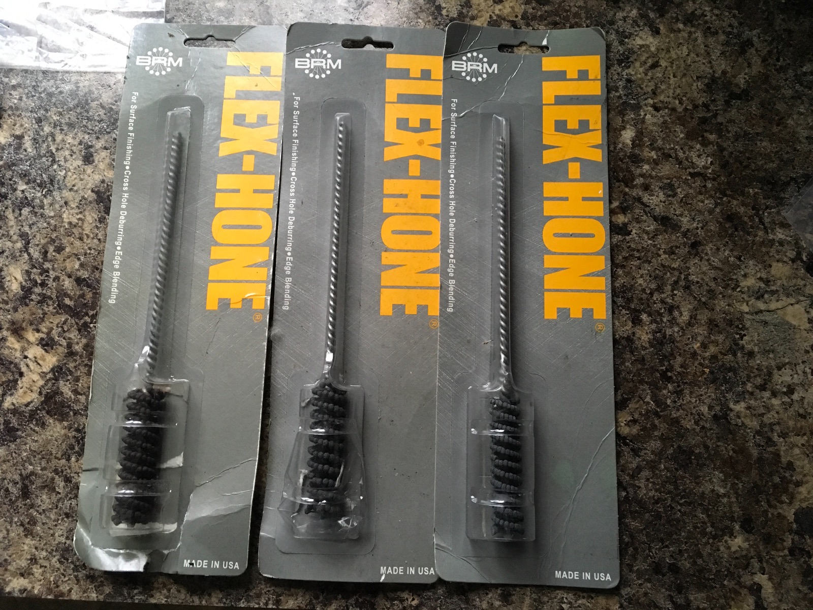

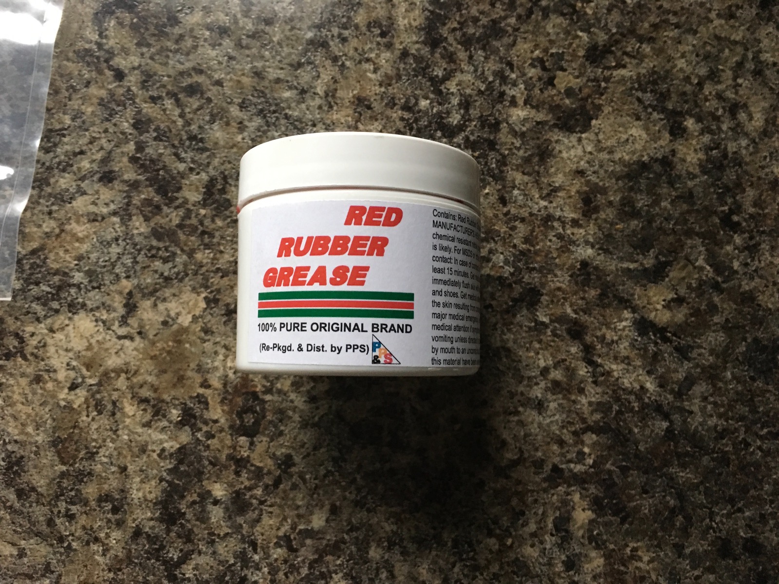

I had a similar problem with my first MC rebuild. I assembled it dry. It wouldn’t work. Then I used grease to assemble, and things worked but I got concerned that I may have contaminated the system with the dissimilar media. So I Remove the entire rear brake system. Replaced the hose, disassembled both the caliper and MC and throughly cleaned. This time I assembled the parts with brake friendly “Red Rubber Grease”. A little extra pumping with the bleeder loose and a clear tube in a jar full of clean fluid. I kept the open end of the hose submerged in fluid and the cap on the MC tight. Checked the MC fluid every second pump and shortly it started to build pressure. Then I bled the system normally, everything closed, pumping the master cylinder several times, holding pressure, and releasing the bleeder screw, then tightening the bleeder screw before releasing the pedal.
If you had low pressure before cleaning and rebuild, I’d replace the seals and piston. You need to run a ball hone in the bore to break the glaze and give the new seal a surface to bite into and work. MOST MC bores are either 1/2” or 5/8. Ball hone are easy to find. Buy fine, medium, and corse grit. I have had success with a 320 grit as the final cut. I’ve rebuilt several and have one going on 5 season and every spring so far the rear brake is firm on the first pump.
