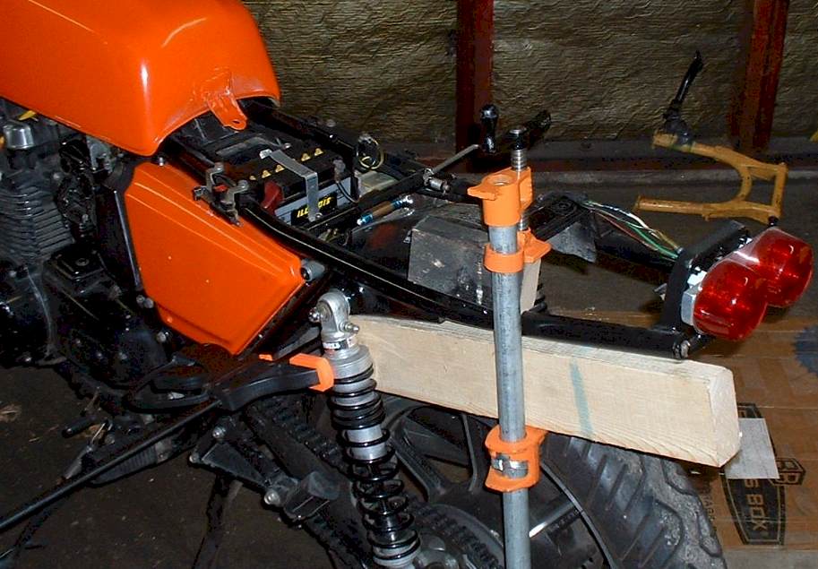

Like Leon said, my go-to is 2 x 4's and pipe clamps.
Here I had the opposite problem. the rear was sagging down on one side.
