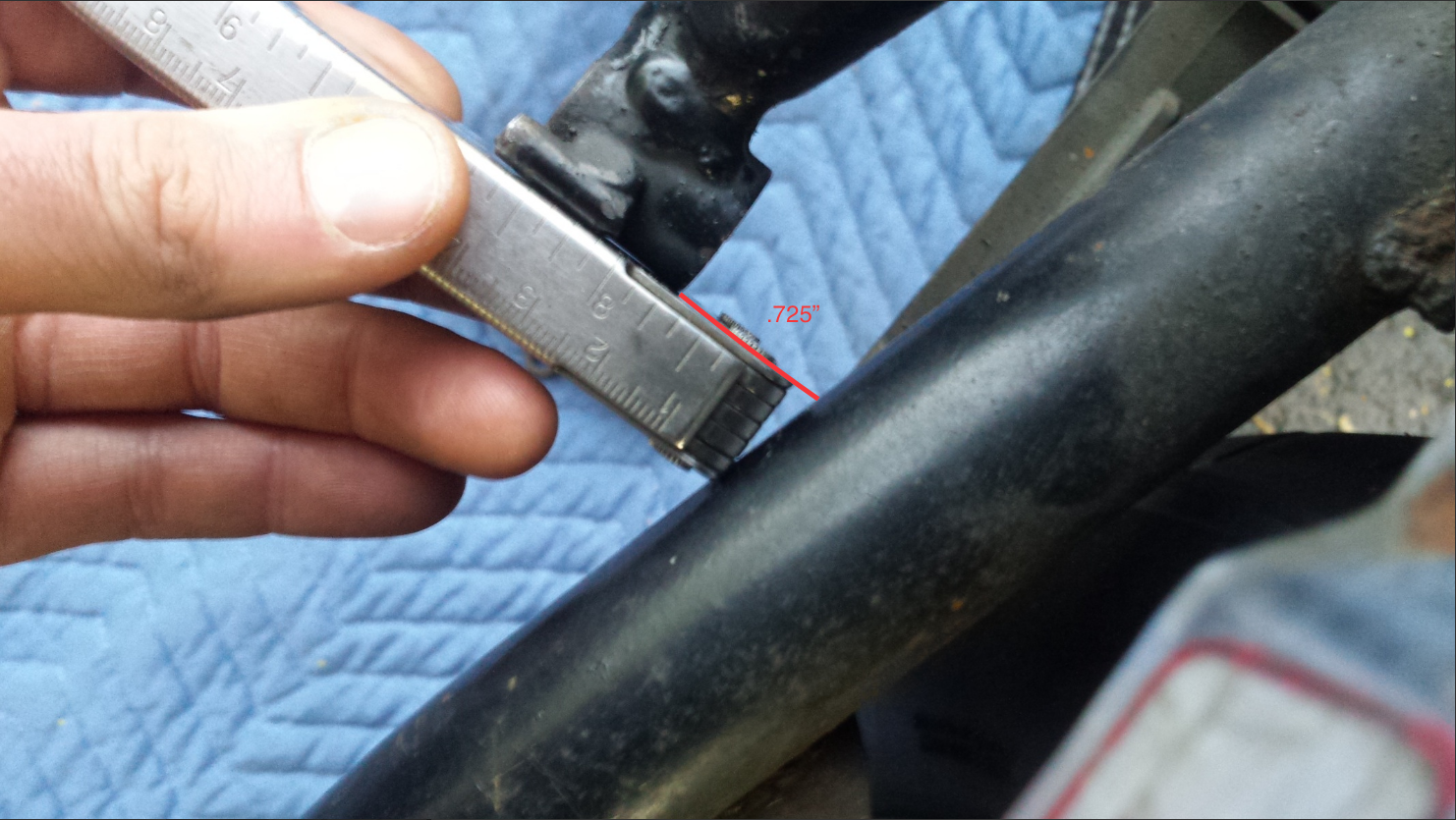

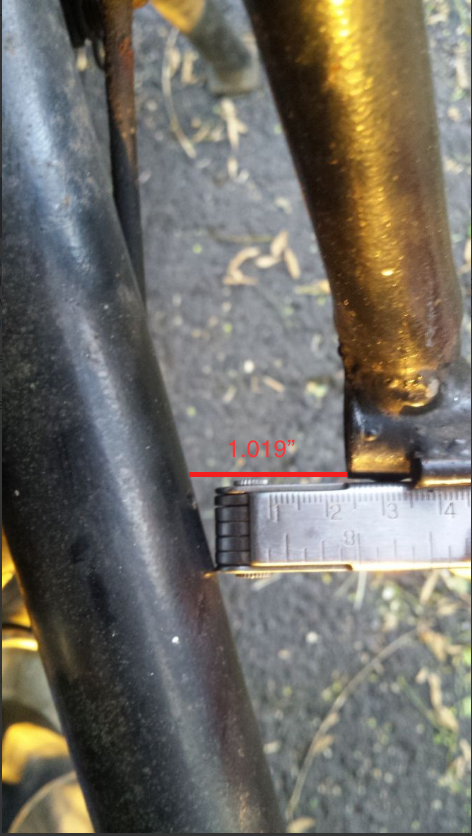

undefined On the off chance that one of you has a KZ440D ltd (belt drive) and happens to see this thread, I would be stoked if I could get a frame measurement. Specifically, I need the distance from the inside edge of the muffler/passenger foot peg mount to the outside edge of the swing arm (see pics). I mostly just want to know if the measurements are equal, so I can assess if my frame is damaged. On my bike, the distances are 1" for right and 3/4" for left. I think the left side has been bent inwards and thus the shorter measurement. Thanks!!

not an application
I used digital calipers on my bike. Those are my numbers.
I took a screenshot of your photos and did an overlay with my numbers and my exact points of measurement with photoshop.
This way you don't have to interpret my photos and my angles on my bike.
You can just look at your photos and see where i measured and what numbers I got for my bike.
my measurements
left .725"
right 1.019"
my measurements
left .725"
right 1.019"
