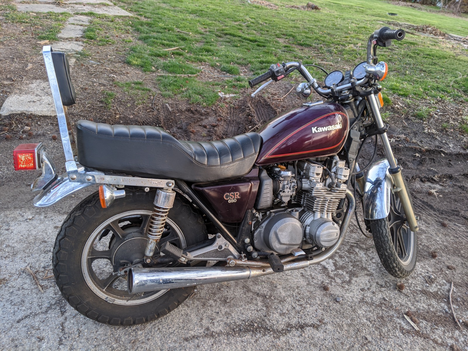

Hey, In need of a few parts that I cannot find. they are for a 83 KZ650 CSR H3
1: I need a master cylinder assembly. or at least a res and plunger. The bike did not come with one and the universal one I got is too small.
2: I need a new rotor.
Any ideas where I can find these parts? I've looked on ebay with no success.

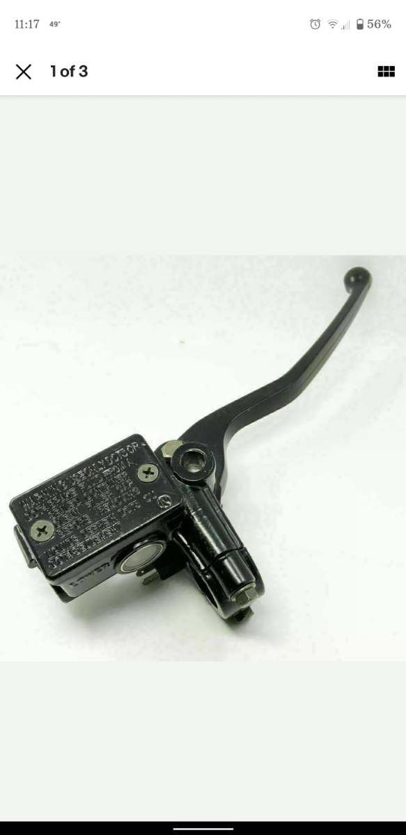

To clarify, the mc fit onto the bars. It just doesn't feel like it has enough pressure when I pull the lever. I can squeeze it until it hits the grip and it couldn't lock the wheel up in wet grass. I went through 3 res full of fluid bleeding them so there is absolutely no air in the system. Nothing is leaking as far as I can tell. So I'm just wondering if the plunger is too small for this bike. New pads were installed at the time I tested.

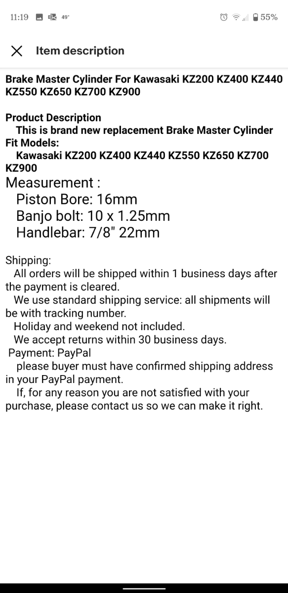

Master cylinder. The 16mm mc in the pic is for a dual disk Fr brake. The stock piston bore for a single disk Fr is 1/2" (12.5mm). The larger bore size will give a different feel to the brake lever.
Z1Ent >> Goodridge speed bleeder SB7100 - 7mm x 1.00 - Pkg 2

How will that affect my braking? I thought a larger bore would give me more aggressive braking performance. Also. I cannot find anything 12.5mm and only found 14mm. Would that be acceptable?

I think most every single disc Japanese bike uses a 1/2 inch (12.7mm) front master cylinder.
