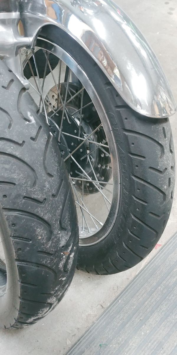

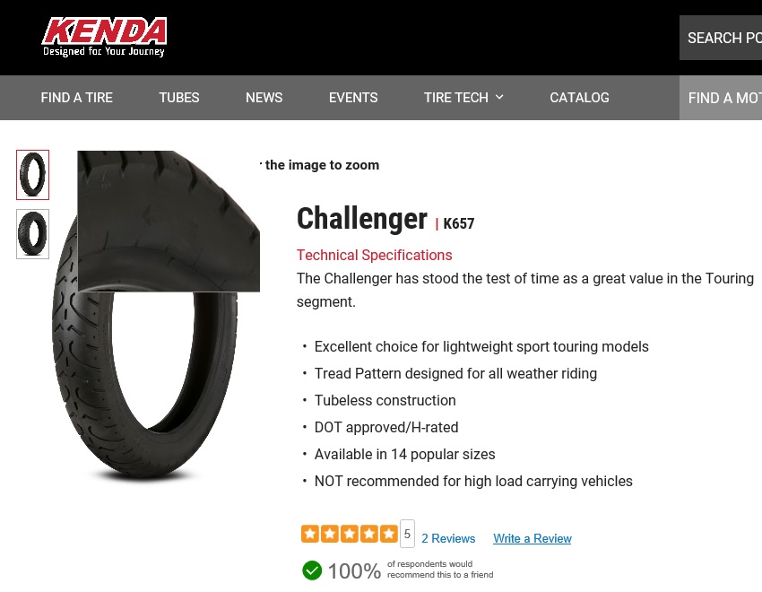

We'll have to look for other markings. I haven't yet found a 100/90-18 rear on Kenda's site that Texas linked to.

I suppose it is possible that Kenda quit making that size in a rear tire since your buddy bought that one.

I had a friend with the opposite situation. He bought a bike and when he went to change the tires there was a front tire (from a Harley Davidson) on the back!

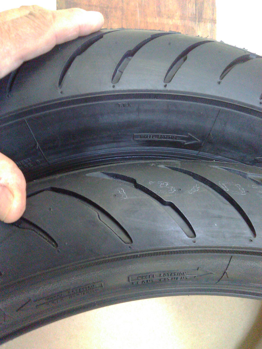

I met a guy riding a new Victory once that said my front Avon Roadrider was on backwards and I told him about it being a dual purpose tire for the front or back but he insisted that the tread was wrong until I looked at his front tire and it had the same pattern as mine, he was bummed

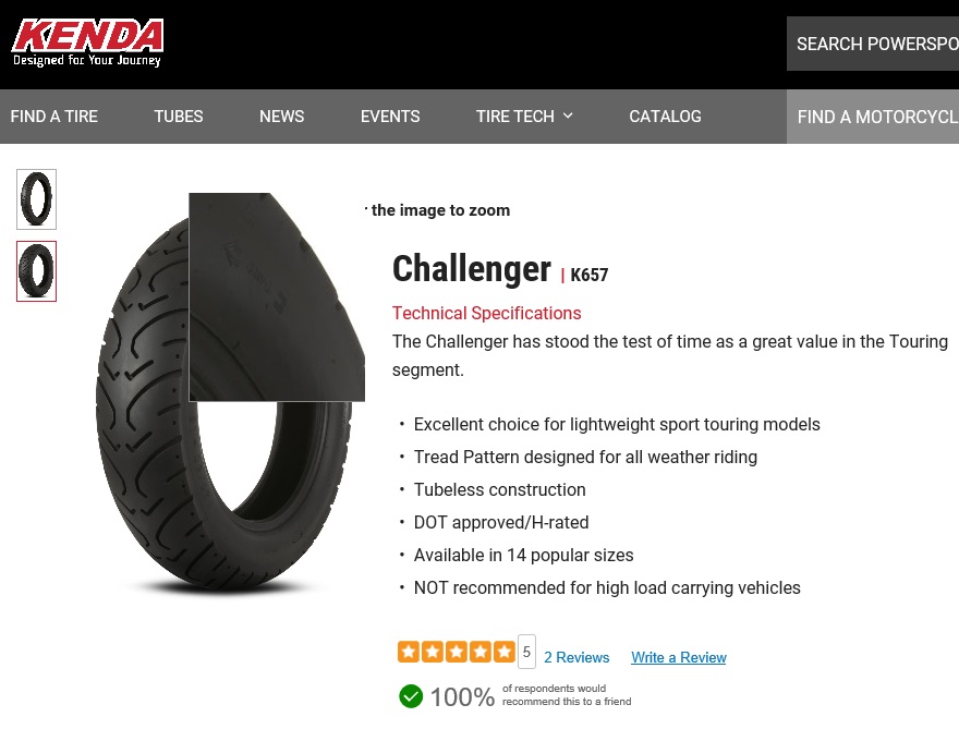

It's still a mystery, I'm afraid. We have an email into Kenda, but no reply so far.
The main thing to figure out, is how to determine if a tire is a front or rear based on looking at the actual tire. We haven't found any obvious "front" or "rear" mark. We have a few other bikes with Kenda Challengers, and on those, the rear tire is marked "drive" instead of "rotation".
Both tires in the original post are marked "rotation".
Both tires in the online graphic are marked "rotation" but those might not be photos of an actual front and rear tire pair.

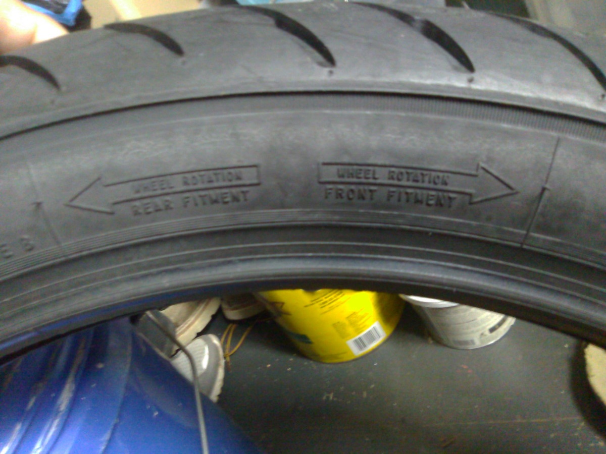

In addition to what Ed said about the traction, it's possible the inner belting construction is designed so that it is optimized to take rotational load for one direction or the other.
Since the same, seemingly directional pattern can be used either way for some tires designed for front or rear use, I guess the water traction is not a factor. If you've ever done much riding in the rain, though, you know traction is a BIG deal in the rain , so it's difficult for me to be comfortable thinking the pattern direction doesn't matter.
As BlueJay shows, he's got two tires with the same tread pattern, but one can be used in either direction, and the other can only be used in one direction. That seems to imply there is something internal, other than just the tread pattern, that determines direction. In his case the one-direction tire is presumably constructed differently than the two-direction tire.
