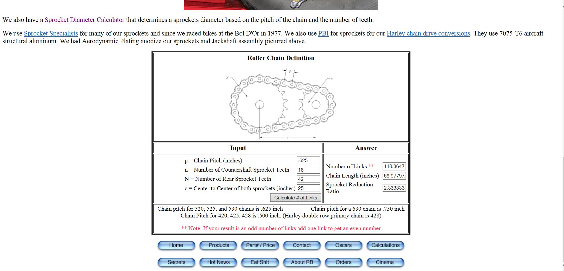

Any idea how many link chain I'll need for the 18-42 sprockets?

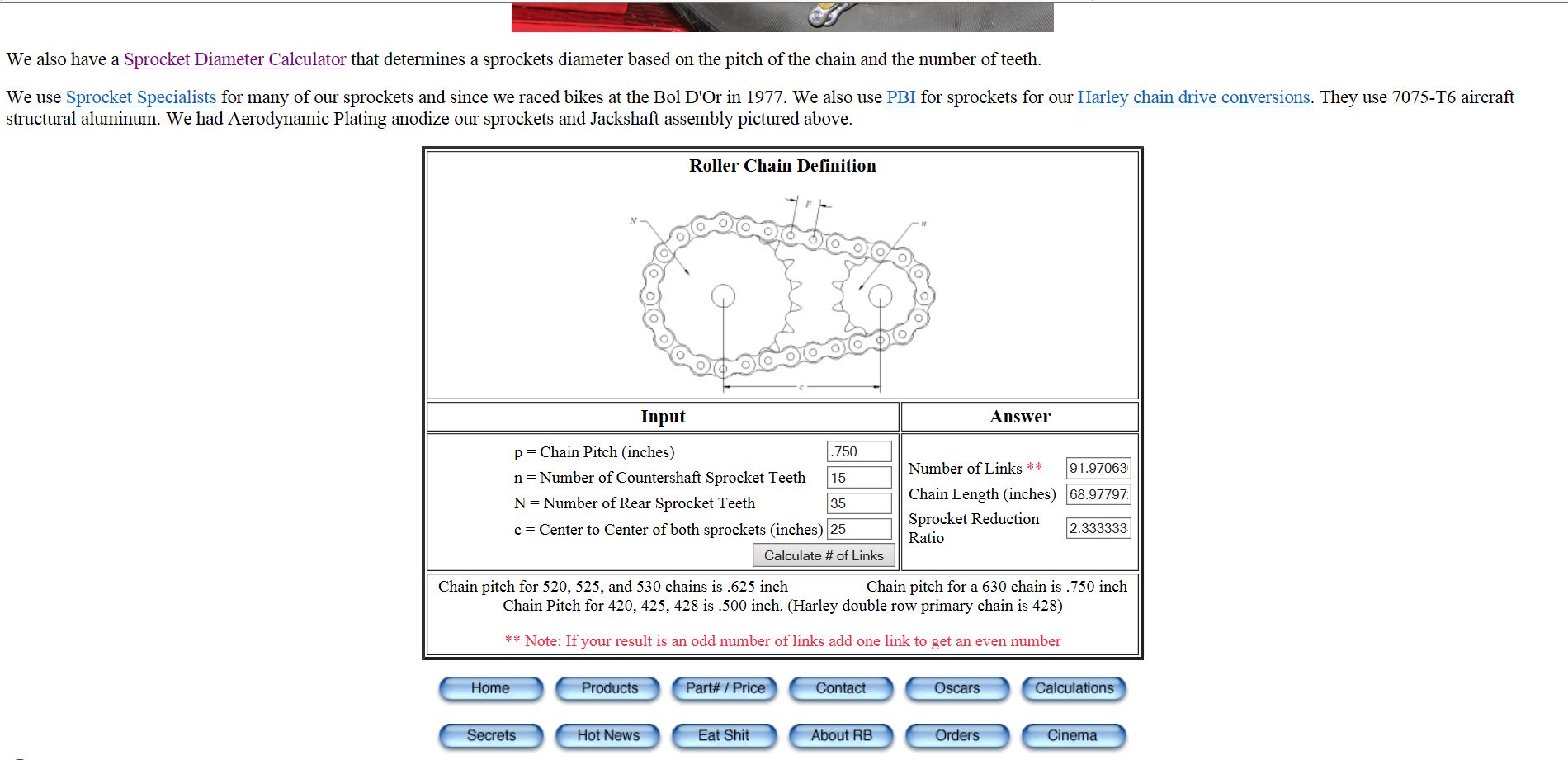

According to the OEM parts fish on Partzilla your bike used a 92 link 630 chain.
630 = 6/8 pitch (.75 or 3/4") and 3/8 wide roller
So 92 links x .75 = 69" long for the chain.
530 = 5/8 (.625") .pitch and 3/8" wide rollers
69" long chain divided by .625 = 110.4 links. 110 should work fine.

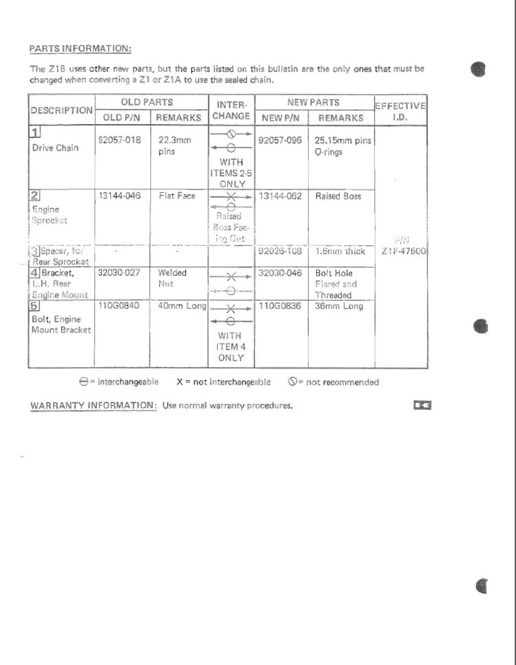

- mrmach5
- Posts: 73
- Thanks: 7
Re: 76 KZ900 630-530 chain sprocket conversion
29 Apr 2020 07:30
I'll be going with the 530 conversion with a 18F sprocket and 43R sprocket.

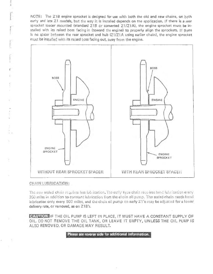

Is there a spacer that needs to go behind the front sprocket ,,,,,,,,,I see these listed - sprocket spacer 25mm x 36mm x 1.5mm ?
- Thanks: 2260
29 Apr 2020 12:21
The following user(s) said Thank You: bluej58, Rick H.
