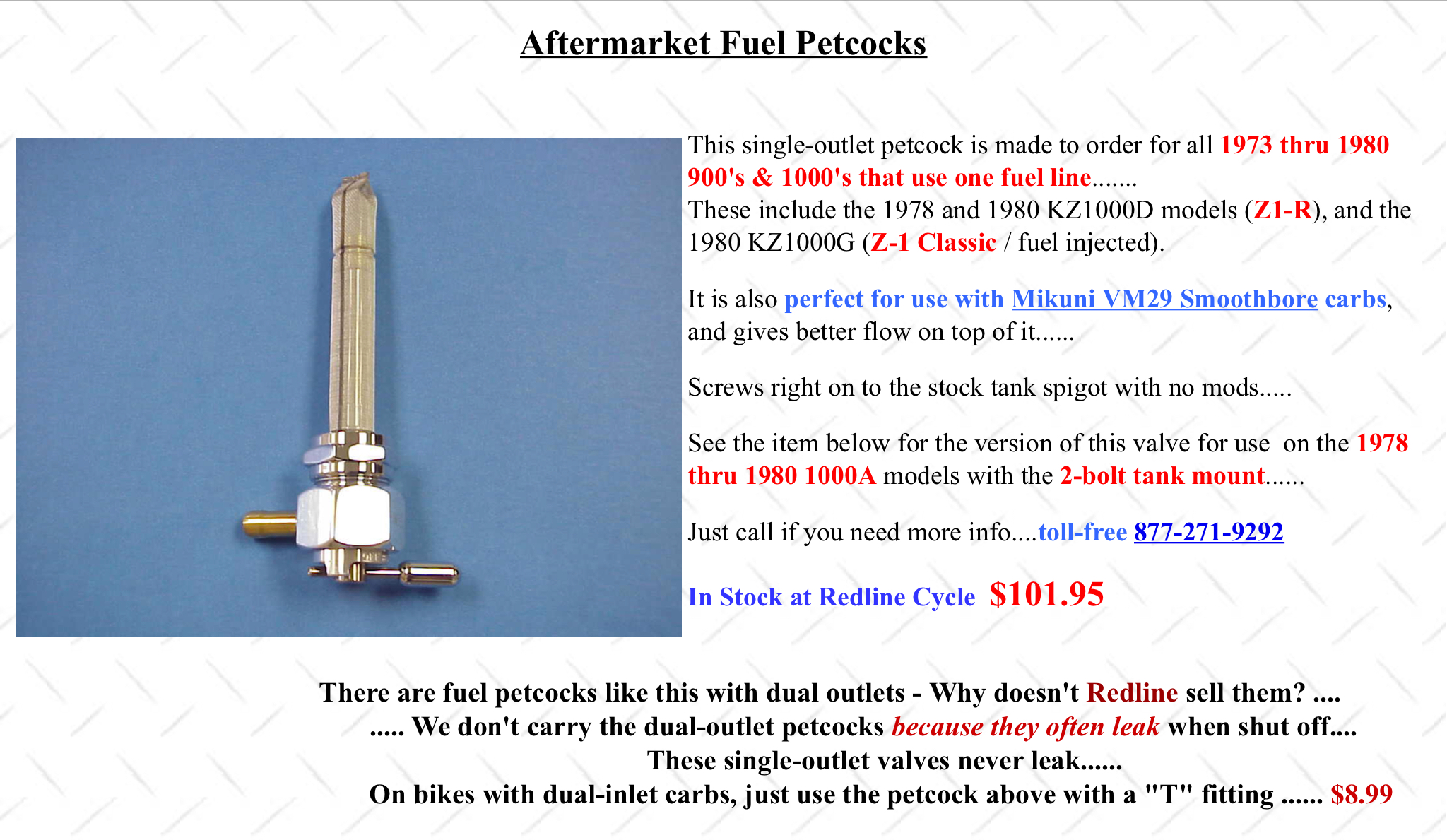

I ordered a new gasket/0-ring for the gas tap and when I tried to install the petcock on the tank I noticed that the threads on the lock nut literally slide over the threads on the gas tap. Unless my guess is wrong, this can't possibly be the correct way this thing should go together. As you tighten the locknut up the petcock threads simply slip thru the threads of the locknut. Has anyone ever run into something like this? The locknut will thread onto the fuel pipe outlet on the tank, but not so for the locknut on the gas tap. If I didn't know better I would say this petcock was an aftermarket replacement and not a very good one at that. There are no markings on the petcock to indicate who made it. Does anyone know the correct part number for a Pingle replacement valve for this bike? I may go that route rather than putz around with the mystery valve I have now. Thanks in advance for any help on this.
