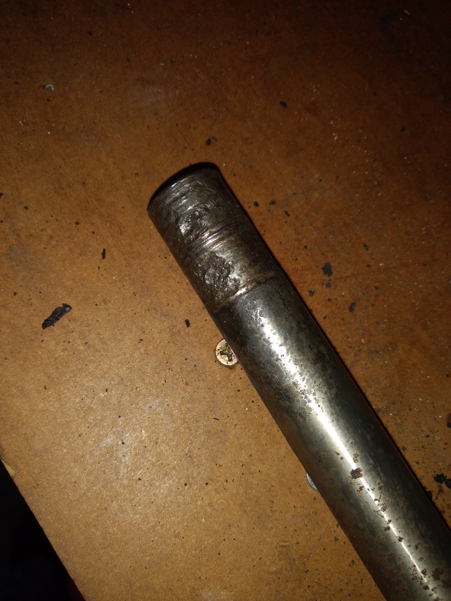

Subject has been discussed but I can't find "The Fix". The needle bearings were destroyed and took chunks out of the sleeve (42036-1102).
My current plan is to cut sleeve into two inner races and make a spacer the take up slack. Does anyone have a better fix, or found a 16mm x 22mm x 40mm ( or longer)? Is it possible to switch the whole setup to the more available bushing setup?

If you were happy with the surface of the inner half of the sleeve, you could cut it in half, and flip the undamaged center ends to the outside, under the bearings... no spacer needed. Maybe treat it with naval jelly first, and knock down any burrs/marring on the surface.

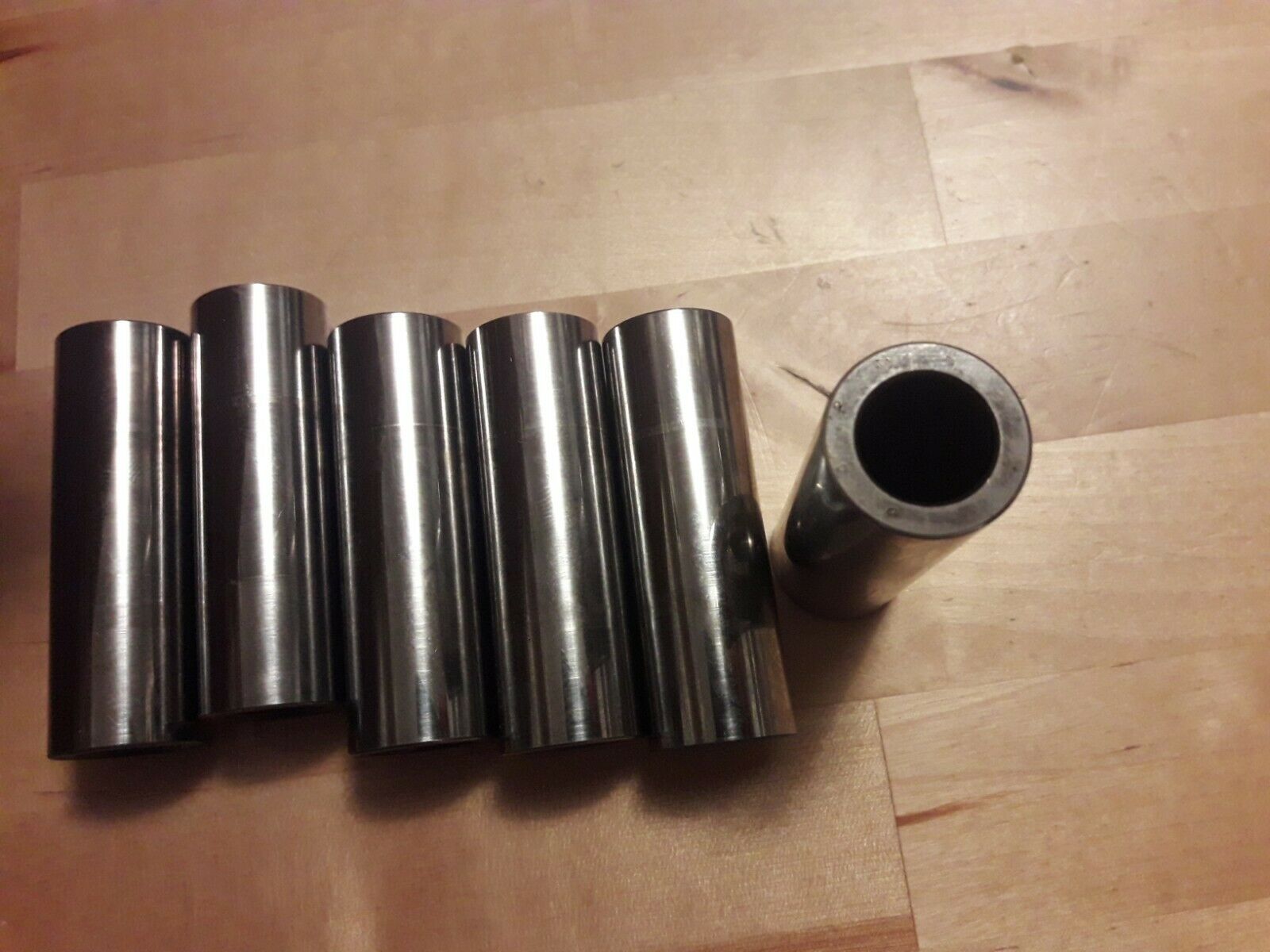

Just an quick thought.
The Porsche 911 Piston Pins (Ø = OD 22 x ID 14 x L 66 mm) can be modify to inner races for your needle bearings.
Some other engines like BMW, Ducati, KTM use the same Ø = OD 22 mm Piston pin.

Scirocco, thanks for the Porsche part solution option.
