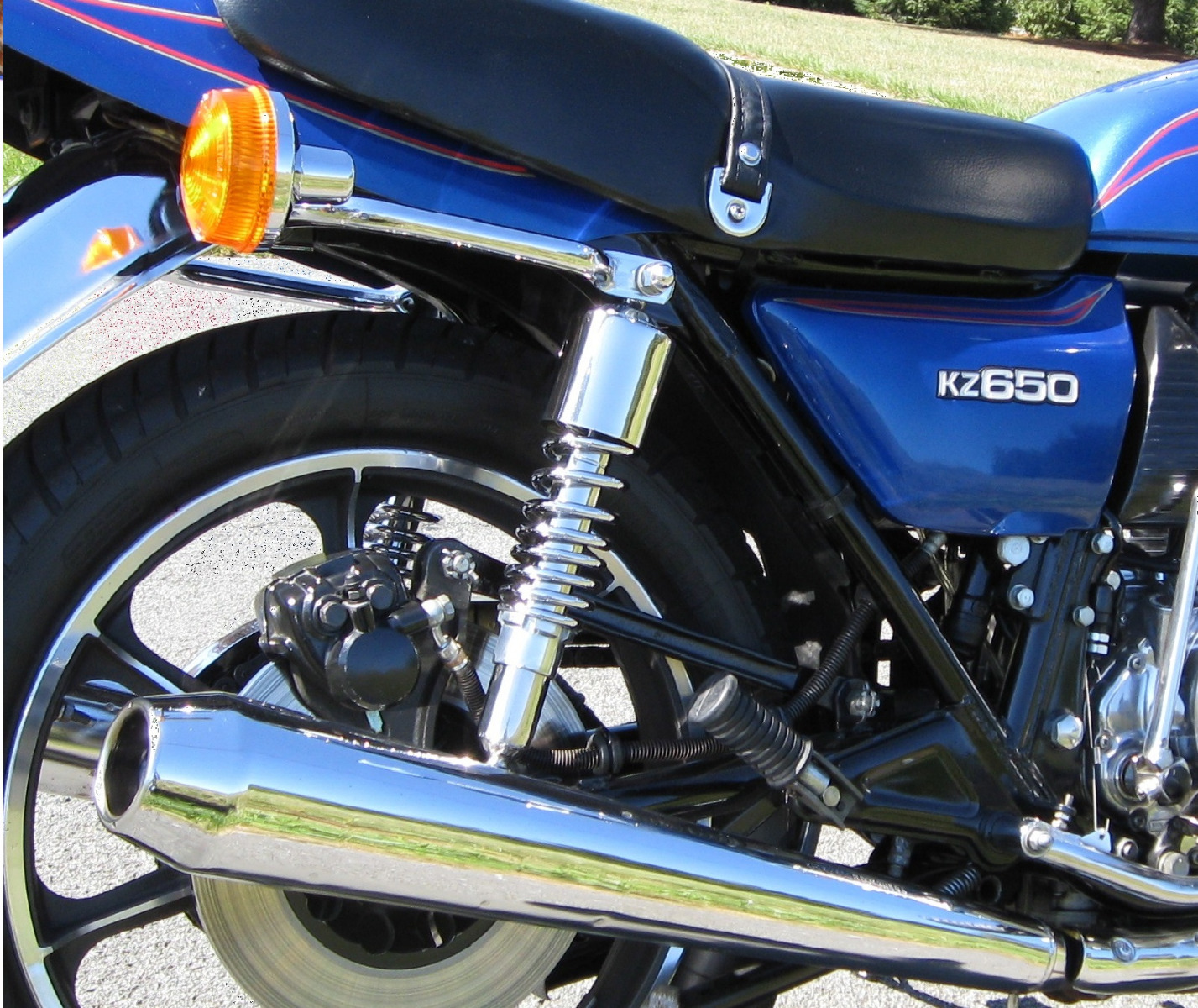

I've been using Hagon shocks (Hagon Custom shocks Classic I - Application Type CC1 (Standard Spring) ) on my KZ650 for more than 13 years (17,000+ miles) and they still work like and look like new. Ed
www.hagonshocksusa.com/HagShocks.htm
Bushing sizes:
www.dimecitycycles.com/hagon-shocks-moto...shock-absorbers.html
Bushing sizes:
Last edit: 27 Mar 2020 19:27 by 650ed.

Very nice build! I'd love to turn the KZ into something like that, but unfortunately we're working with a extraordinarily limited budget
