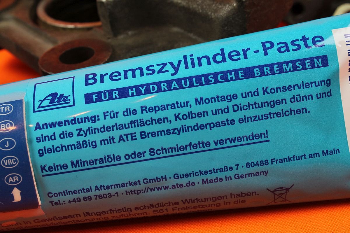

Don“t use any silicon or minaral oil on brake parts (can destroy rubber parts and seals), use some Special assambling grease for inner break parts.

Yes,some high quality caliper grease would probably be best.

Good point folks on the grease! In fact I found one in my workshop from last caliper repair...

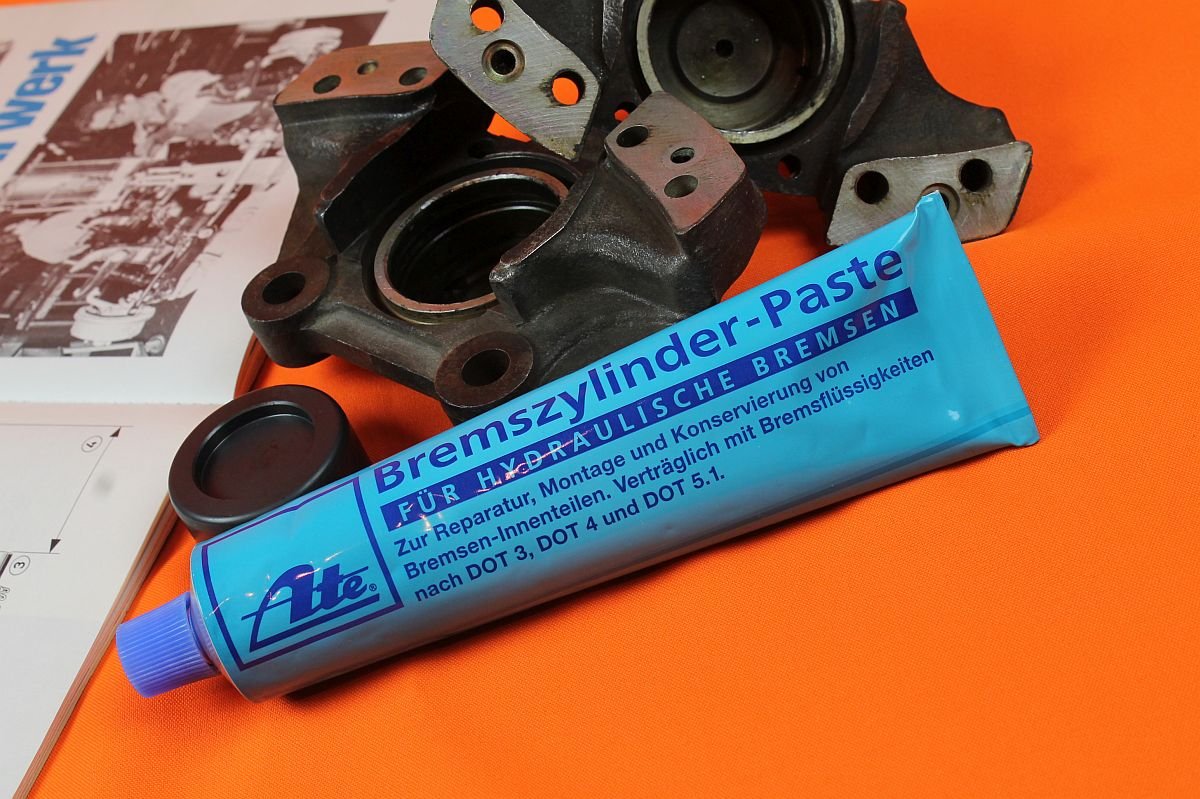

Red Rubber grease is included with some brake rebuild kits. I'm not sure if that's a brand name or a generic designation. Castrol makes the product I've seen, but I've never used it. Someone from the UK on another forum recommended it.
