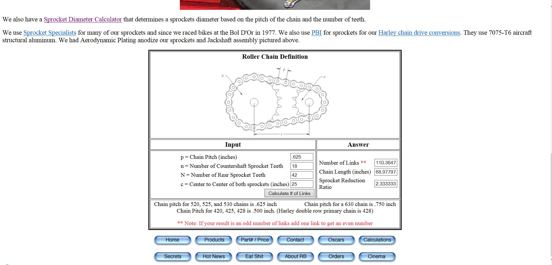

I'm planning on switching to a 530 chain on my KZ900 this spring. Could someone tell me if I need a spacer on the front sprocket and how many links will I need? Also how many teeth front and back for all around riding?

As for my bike application.
630 chain
530 chain
You can try your own bike spec calculations here.
www.rbracing-rsr.com/chainlength.html
630 chain
530 chain
The following user(s) said Thank You: Robb2018

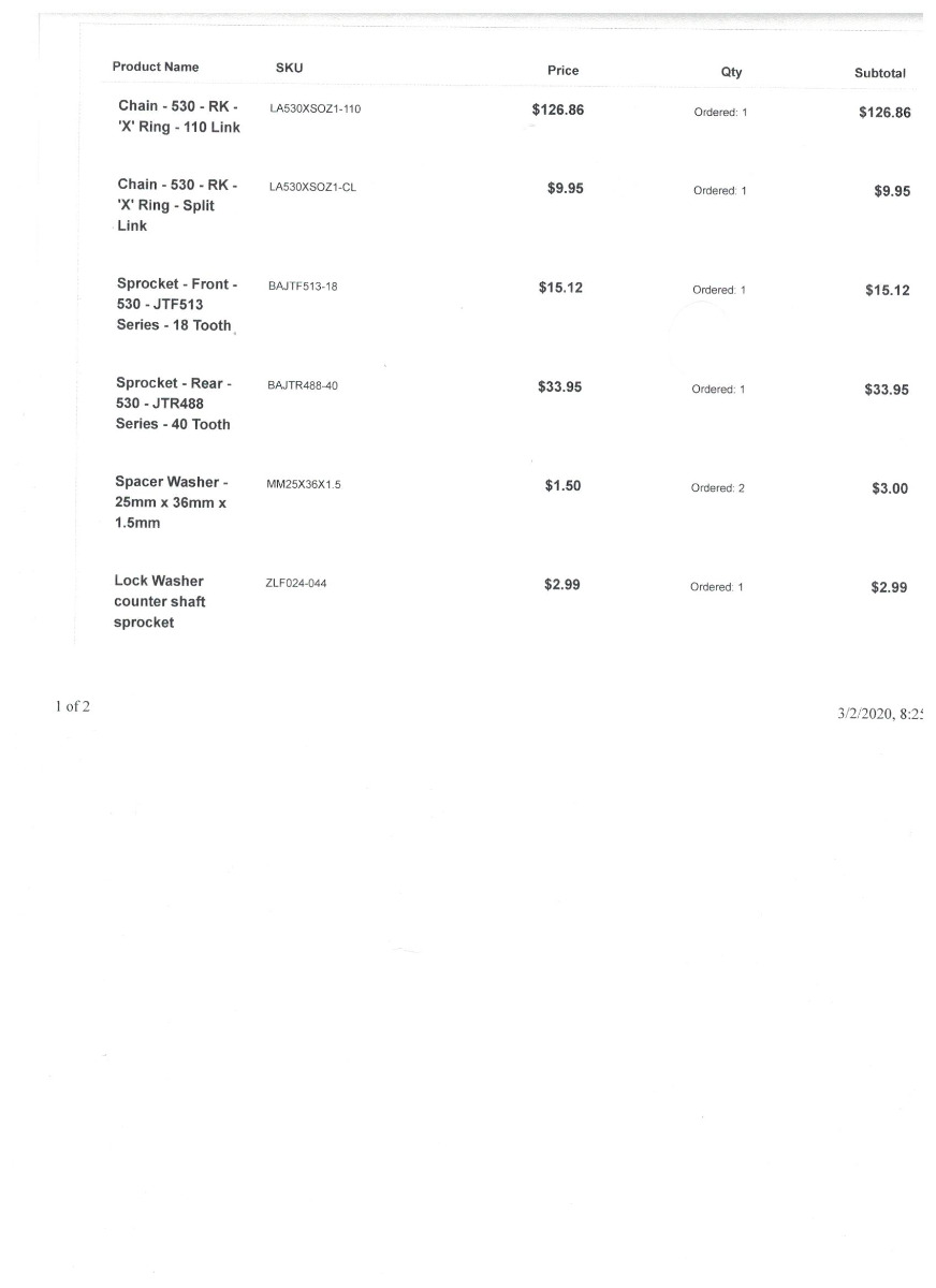

I just bought this setup from Z1E for $203.00 delivered
It includes 2 spacer washers , a lock washer and a split master link.
This setup is very close to the stock ratio for my 78 1000, just a slight increase in rpm's
Not sure if I'll need any spacers yet but they are dirt cheap so I got a couple
