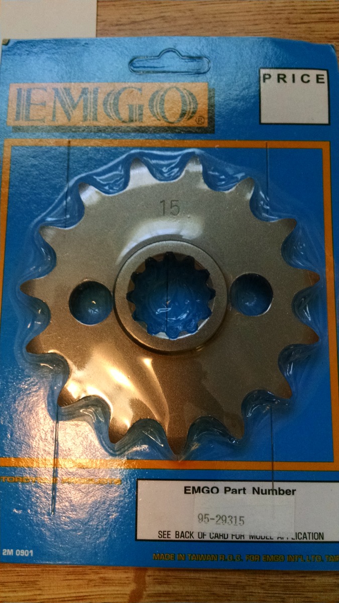

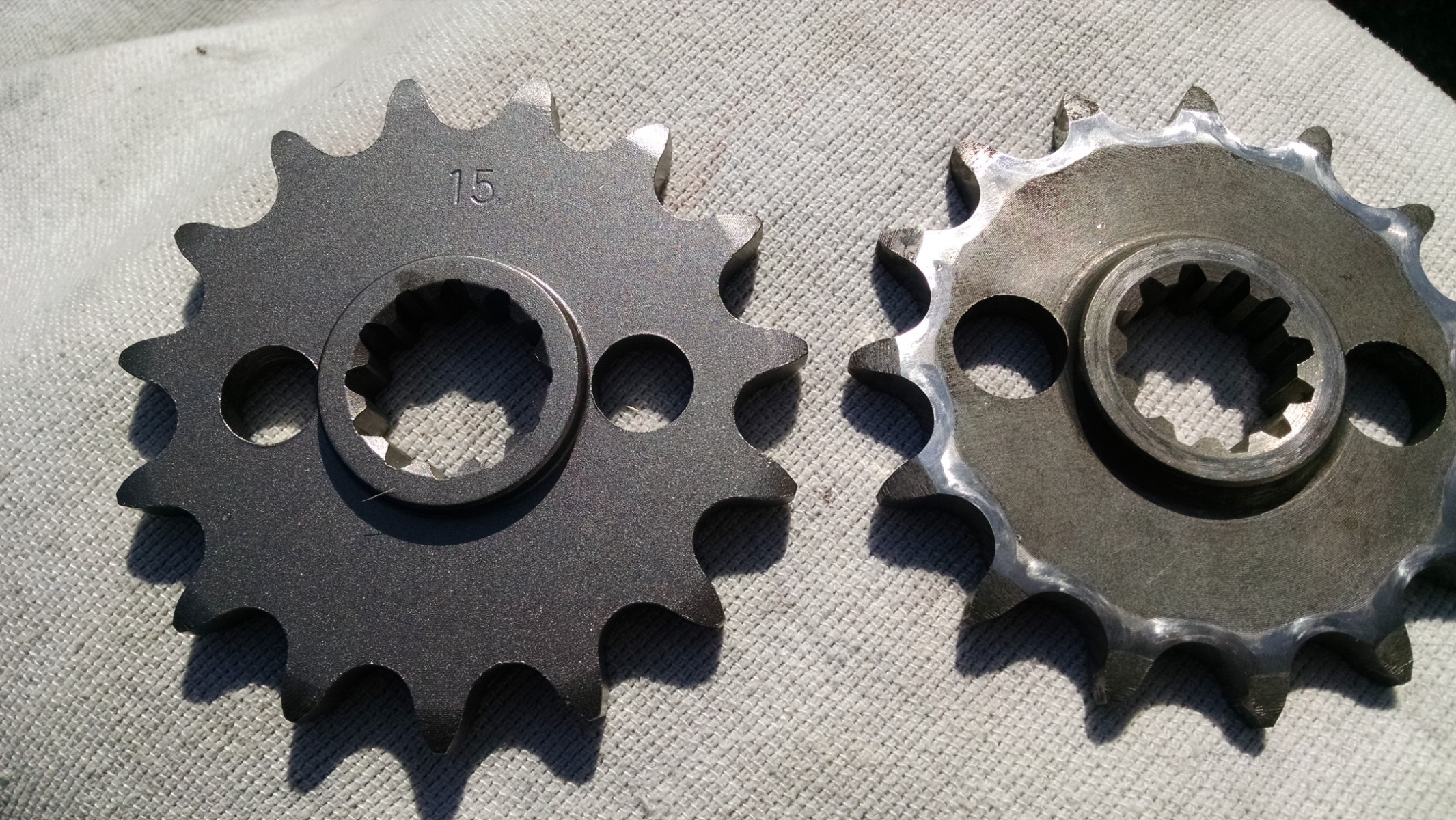

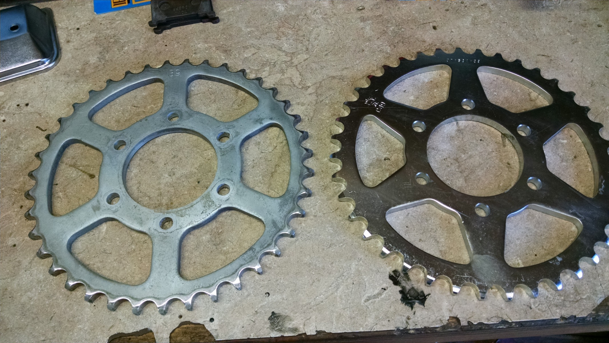

I bought my replacements from Z1 a few years ago.
They look slightly different from the original OEM I removed, but seem to be holding up ok.
Matched up.
The front sprocket holes were smaller, so I had to modify the nut locking tabs to fit.

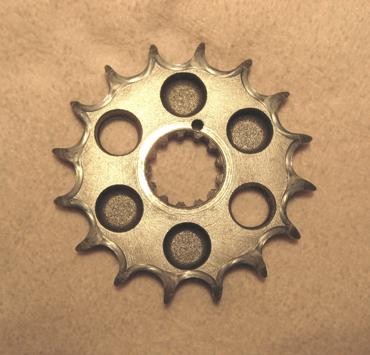

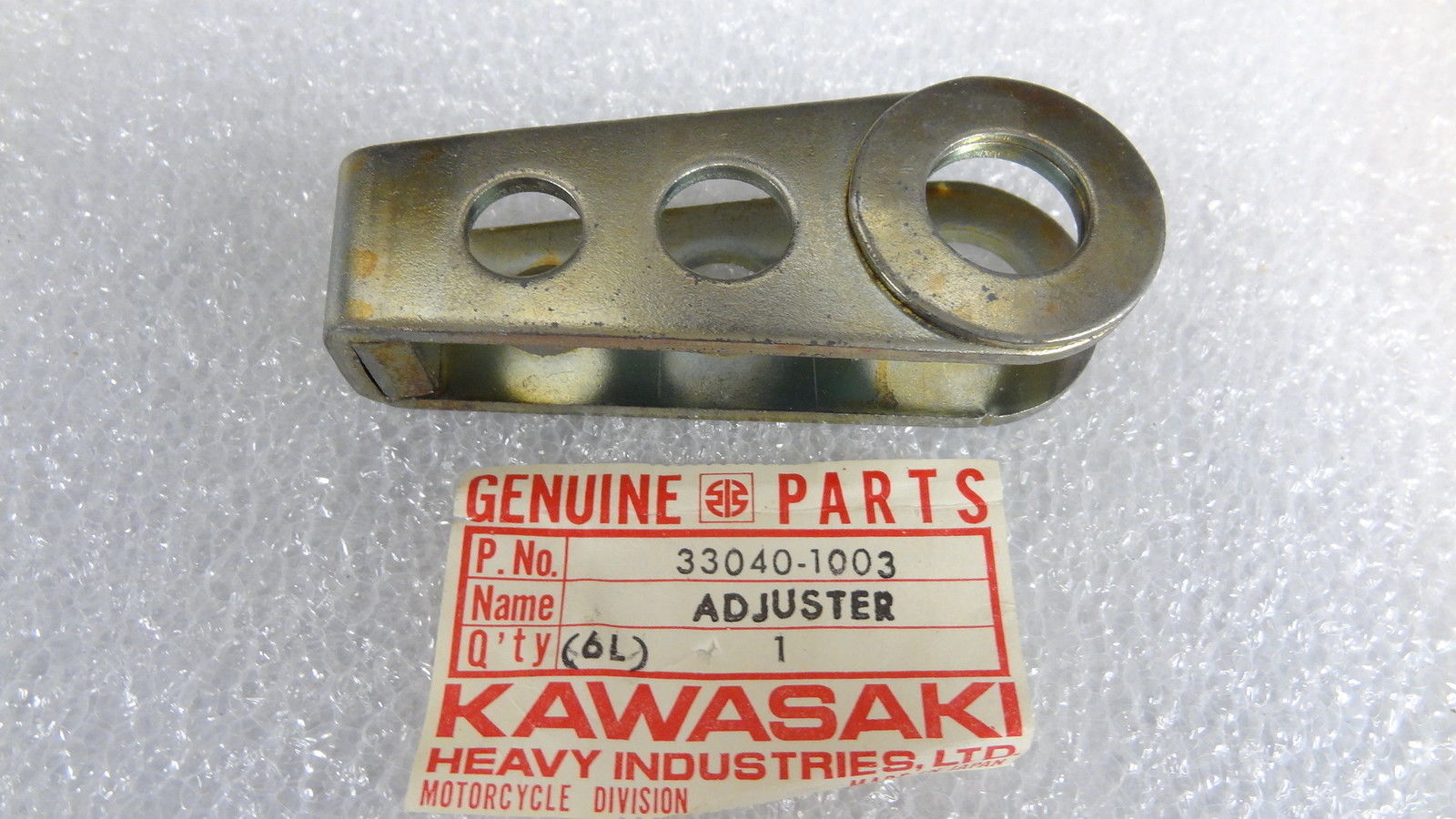

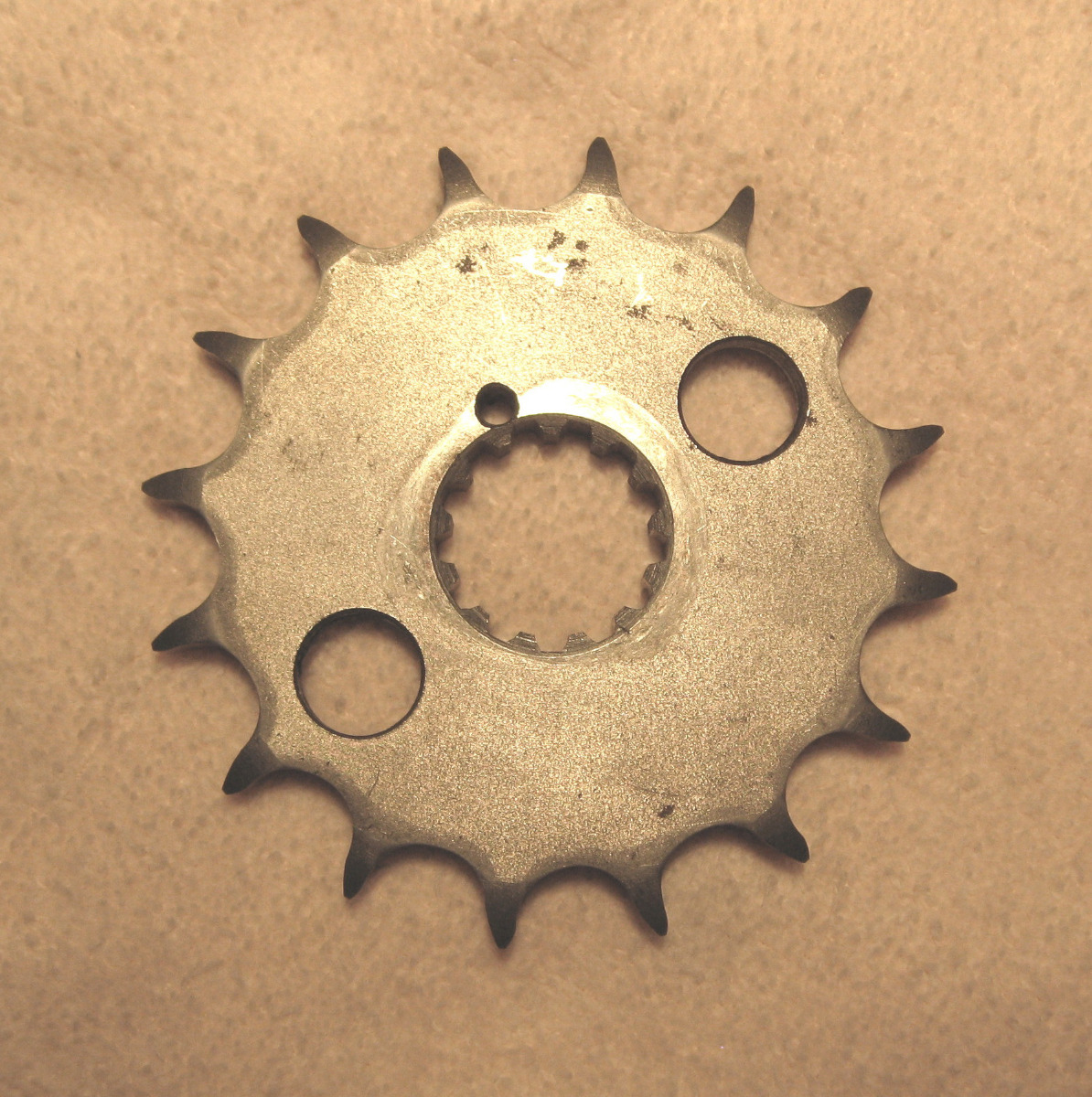

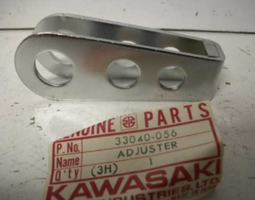

06 Feb 2020 16:36 - 06 Feb 2020 16:38The wear on the surface that counter sprocket reminded me of the wear on my original counter sprocket (see image below) although mine was probably worse. On my KZ650-C1 I found that the chain adjusters were mounted on the wrong sides. The two chain adjusters on the KZ650-C1 are different than each other in that one has a washer permanently attached to it, and if that adjuster is mounted on the wrong side the rear wheel is shifted slightly to one side.
This may not be the case with the KZ1000 models, but for anyone with a KZ650-C1 who reads this it’s worth noting. Ed
ONE SIDE
OTHER SIDE
RIGHT SIDE ADJUSTER
LEFT SIDE ADJUSTER

Z1 Enterprises sells a 33 tooth 630 pitch sprocket. I have no info on it but I've used Z1E many times and never had bad product from them.
www.z1enterprises.com/630-jtr501-series-33t-rr-sprocket.html
Z1 slack adjusters have fixed washers on both sides. They can be switched from side to side but they need to go in right side up so that the adjusting mark is next to the swingarm.

Wow ed, thems some worn out stuff. You must be pumpin sum hella HP to that gear. :woohoo:
Seriously, I can't imagine what looks to be ~.065" - .125" offset to cause much side wear, but stranger things have happened.
