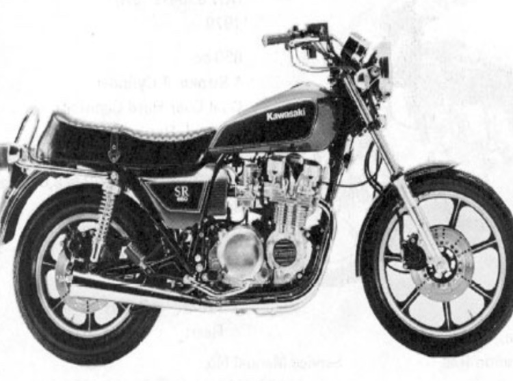

I have a 1981 KZ650-D4 (The SR series of KZ650 was internally known as the Kawasaki KZ650D.)
And wondering if there is other gas tank than my orginal who will fit my frame and support/brackets?

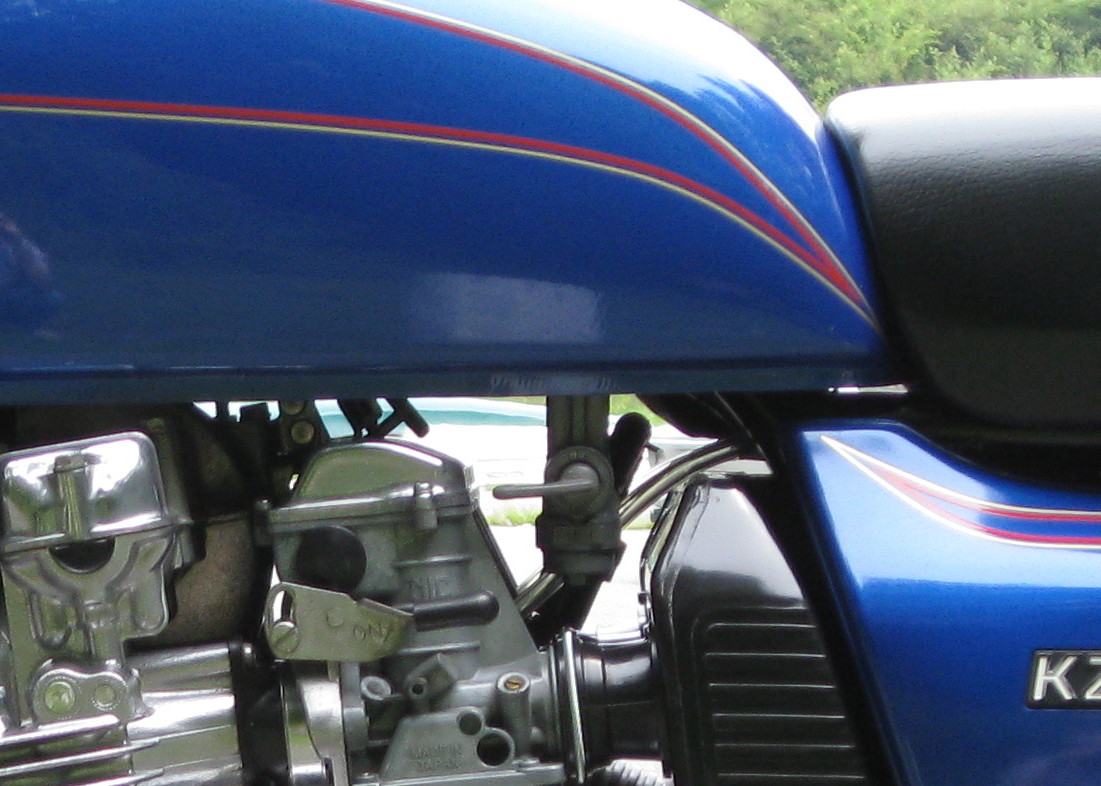

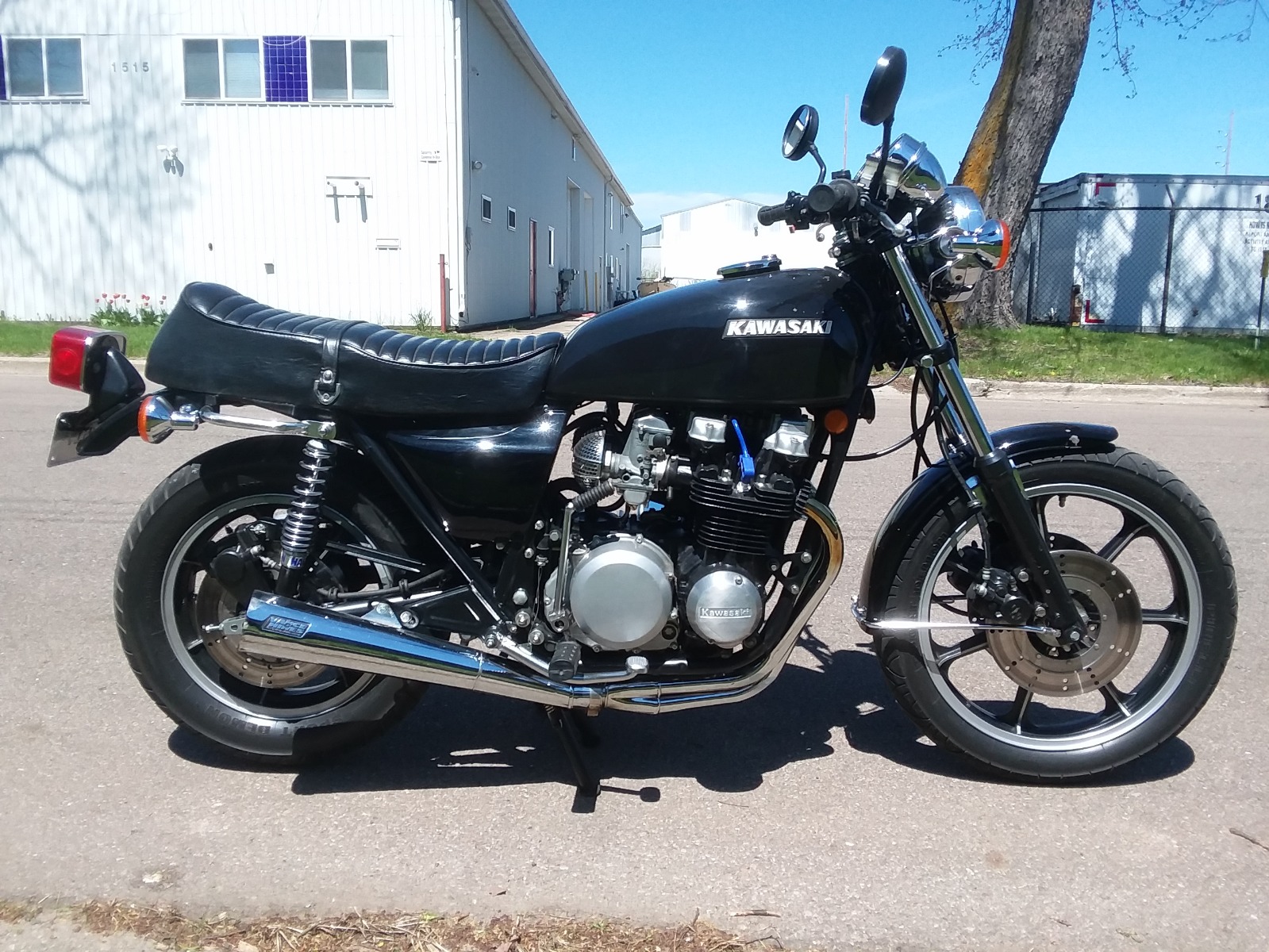

oops, don't know what happened to my text...anyway what you saw is a 77 b1 tank on a 78 d1

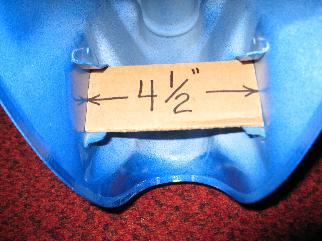

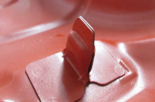

I don't know how the F1 mounts to the frame, but below are pics that show the 1977 KZ650 B & C model tank mounts. Ed
FRONT MOUNTS
REAR TANG

650ed wrote: I don't know how the F1 mounts to the frame, but below are pics that show the 1977 KZ650 B & C model tank mounts. Ed
FRONT MOUNTS
REAR TANG
They look identical to my tank !
