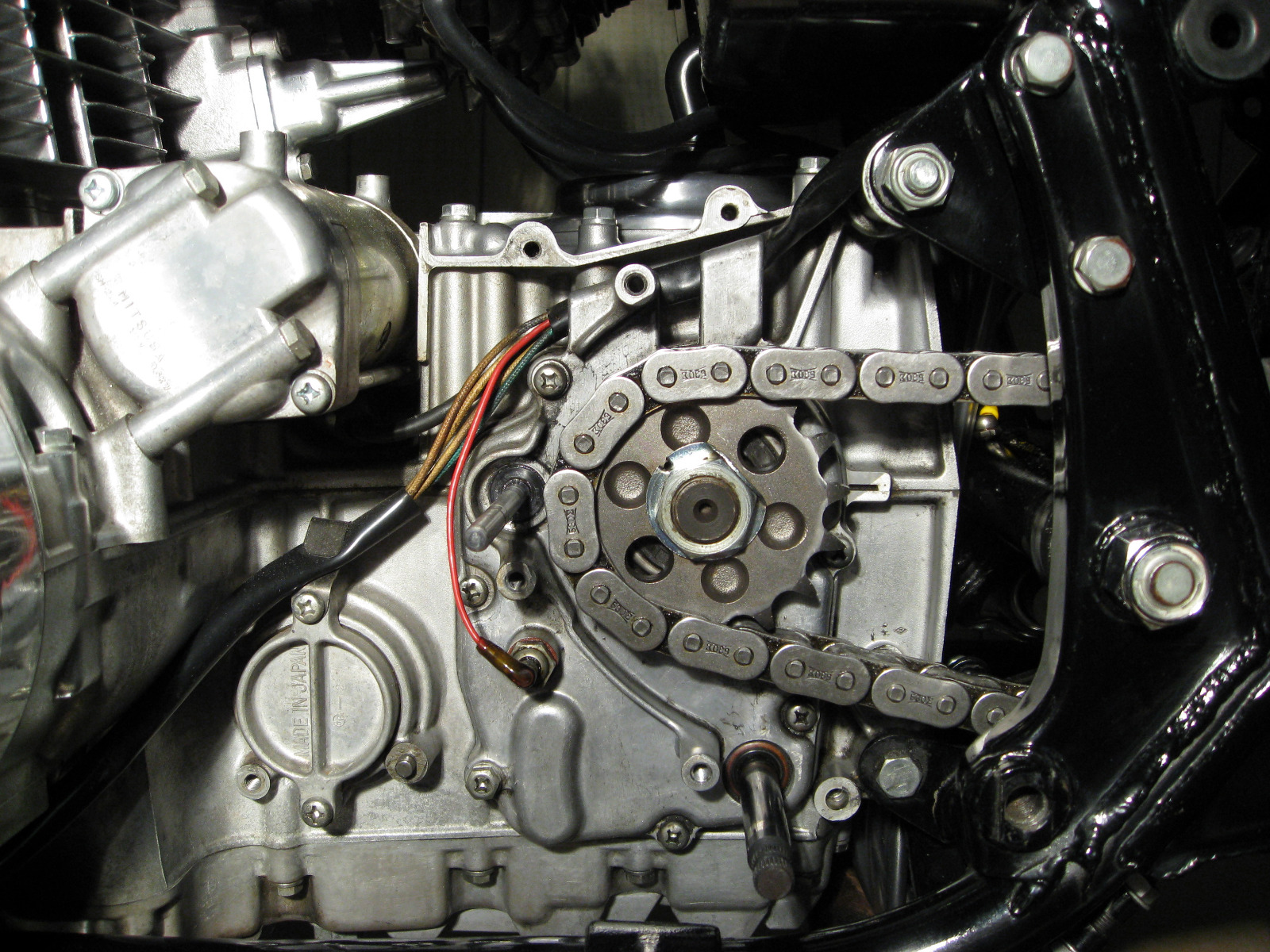

  • rangeroy
  • rangeroy's Avatar
  • Posts: 61
  • Thanks: 35
Re: KZ650B front sprocket
29 Jan 2020 11:24
#818177
use a splined washer, when you bolt it up its slightly offset to match with the bolt holes, the sprocket floats on the shaft but its no problem

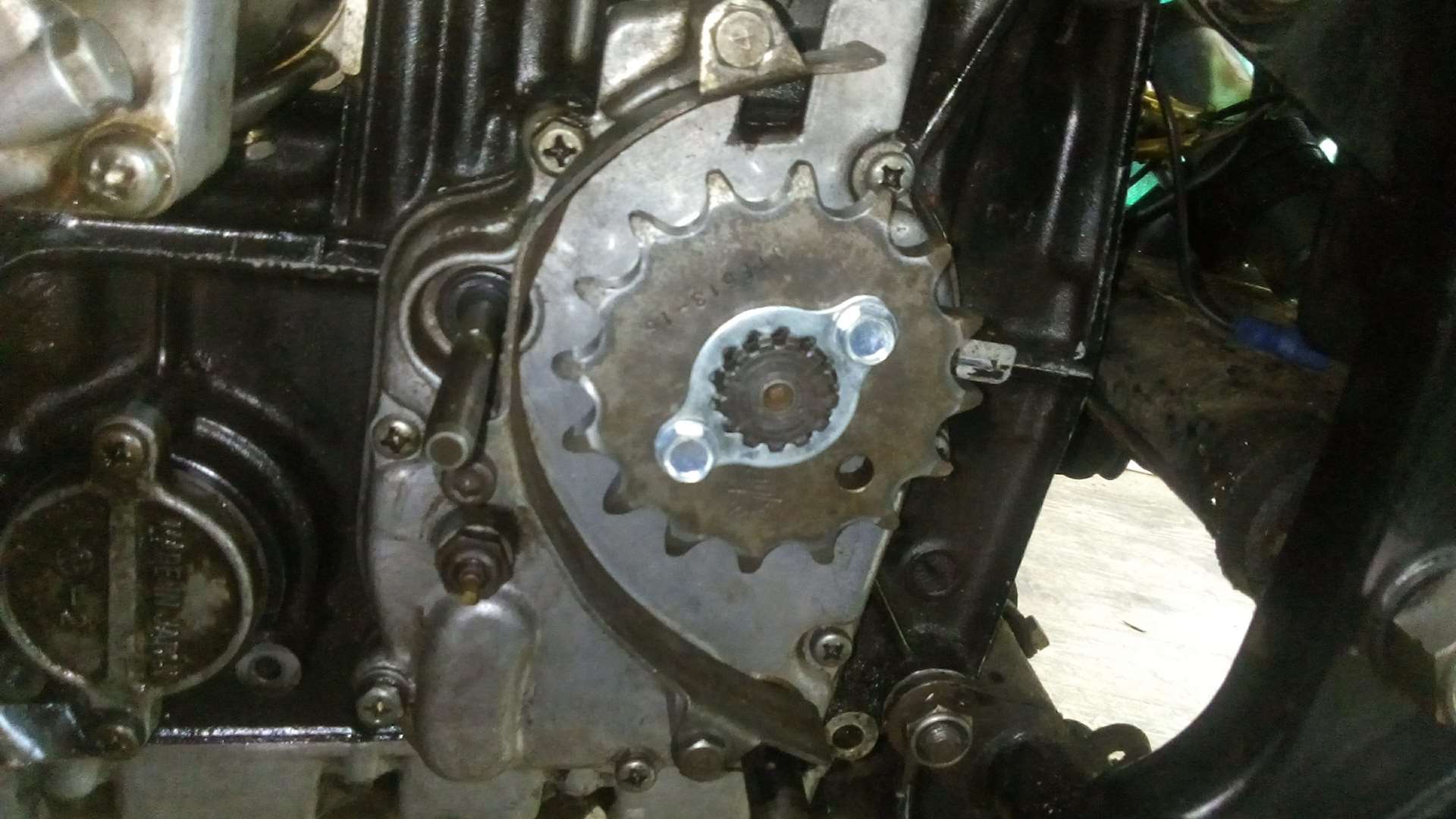

  • 650ed
  • 650ed's Avatar
  • Posts: 15334
  • Thanks: 2832
29 Jan 2020 12:44 - 29 Jan 2020 12:51
#818185
rangeroy wrote: use a splined washer, when you bolt it up its slightly offset to match with the bolt holes, the sprocket floats on the shaft but its no problem
He has a KZ650. The KZ650 countersprocket setup is different than the photo you posted. Below is a KZ650 countersprocket. Notice the end of the shaft is threaded with a nut on it. Ed
Last edit: 29 Jan 2020 12:51 by 650ed.

  • rangeroy
  • rangeroy's Avatar
  • Posts: 61
  • Thanks: 35
31 Jan 2020 11:33
#818309
glad you got sorted, the pic/post I put up is a z650 (mine) but its got a 6spd gearbox fitted & I forgot about the output shaft been different :-( sorry for any confusion
1977 z650
