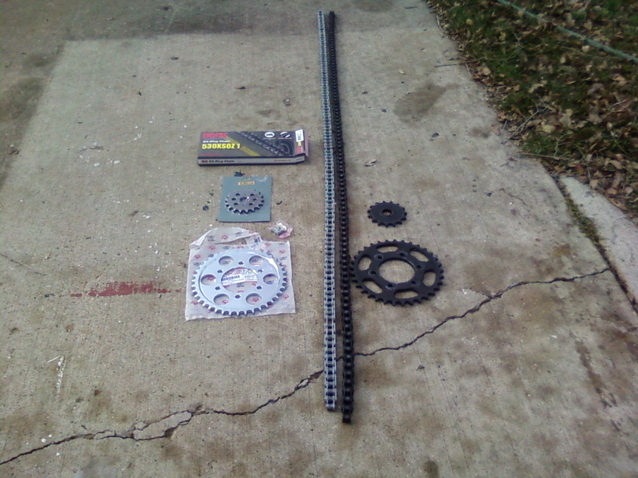

I found a old/bad pic of the first set of 530 I bought before Z1E made the move and I think I count 18 teeth on the front sprocket, don't know what happened on the second set but I will be ordering 18T / 40T this time, thanks again guys
