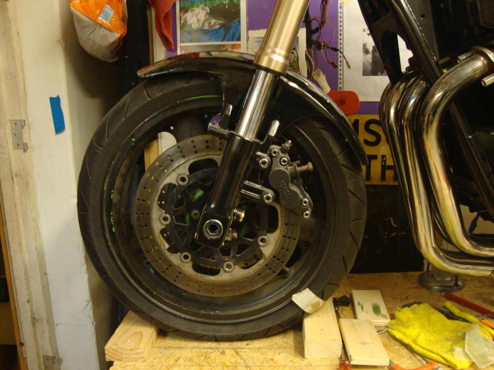

I have a ZX9R front on my Z (with 17inch ZXR wheel) but the forks are usd not rwu. I didnt lke the ZXR mudguard (too modern) but it comes in 2 pieces. I took the rear half and made a mold of it from builders foam, doubled it up and made a complete mudguard from 2 rear halves in fiberglass. It came out really well,I was very happy with it and it has a more classic look to it than the original.
The process is in the build thread (page 14) if youre interested. Link in the signature below

No eBay APP ID and/or Cert ID defined in Kunena configurationLet us know what you plan on doing. I have some 636 forks that I need to make a fender for. I think that I will be ordering a generic one off of ebay and adapt some arms to attach to the forks.
