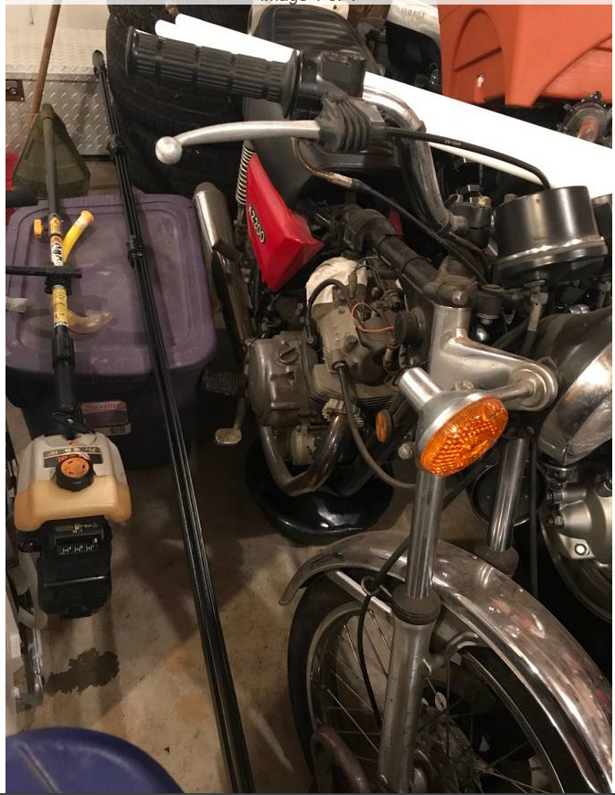

Hey Shaun,
I don't know where you live or if you are even interested but this has just been relisted in Hobart Indiana.
Great price for a no mile titled kz200
chicago.craigslist.org/nwi/mpo/d/hobart-kz-200/7058905005.html
