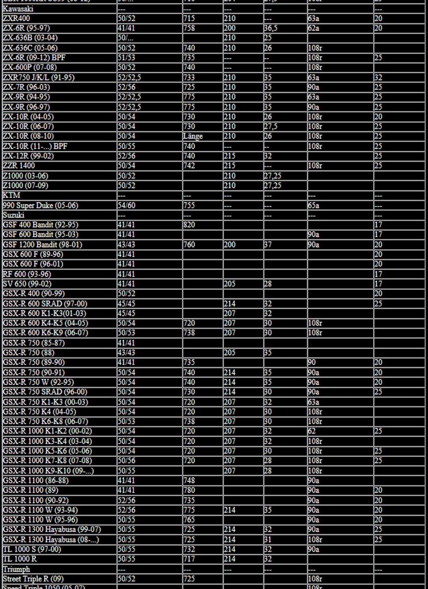

You will swap three diffrent bike model parts to the front and rear end, no way Buddy. Best way to take the ZX9R B model wheel, fork, brake and speedo drive.
Too many diffrent spacings and axle/bearing Diameter.
This site list some modern bike brake, swingarm, fork and suspenion write up.
www.sellifighter.de/technik/masse/masse.htm

Cheers Scirocco. Great data on the chart.
I'm pretty much set on the C1 forks as I prefer to keep the RWU look, also I have some articles on it being done before but with digital speedo. the ZX6 / ZX9 bearing diameters are the same size & I have access to enough machinery to modify/make custom items.
There appears to be quite a bit of carry over between Kawasaki models so hopefully with a bit more research & tapping into the knowledge on here I may get there.
