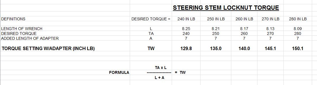

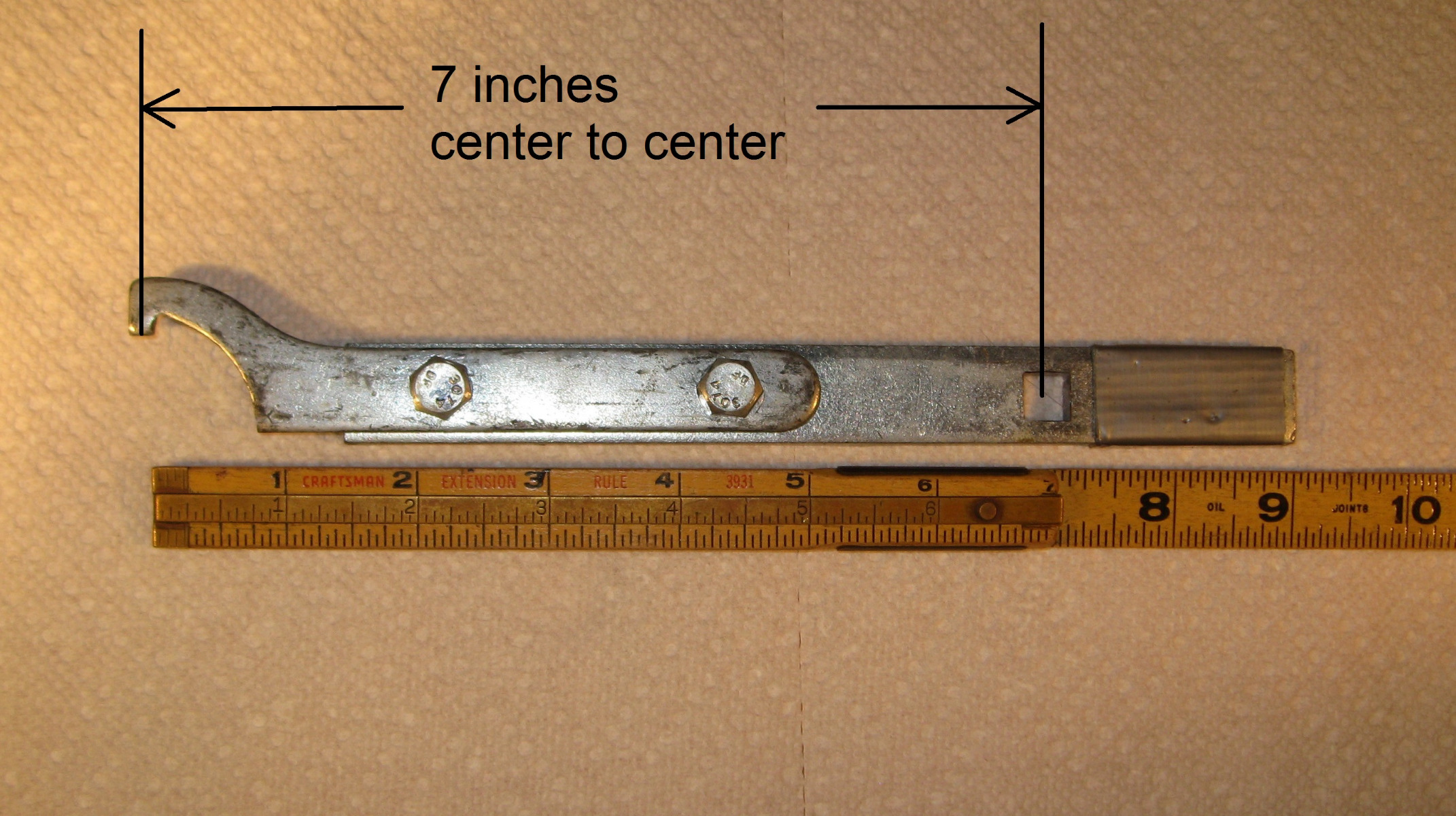

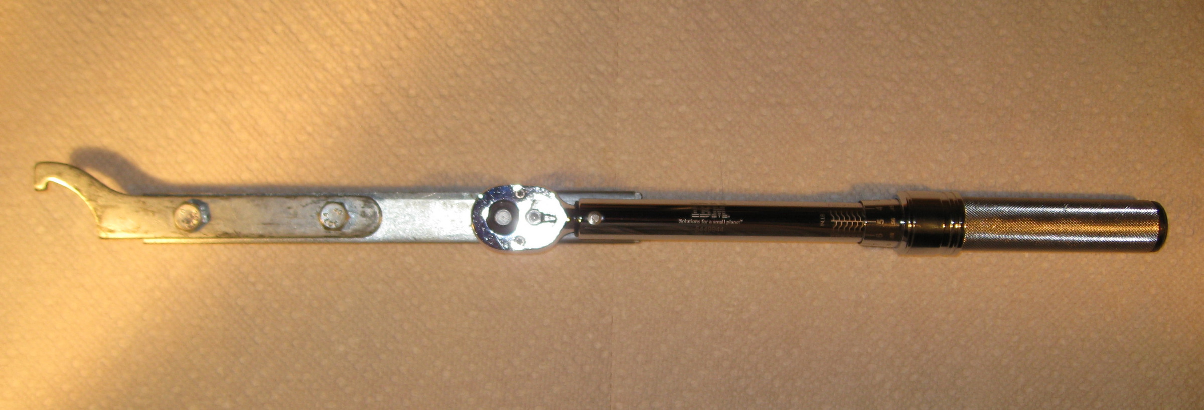

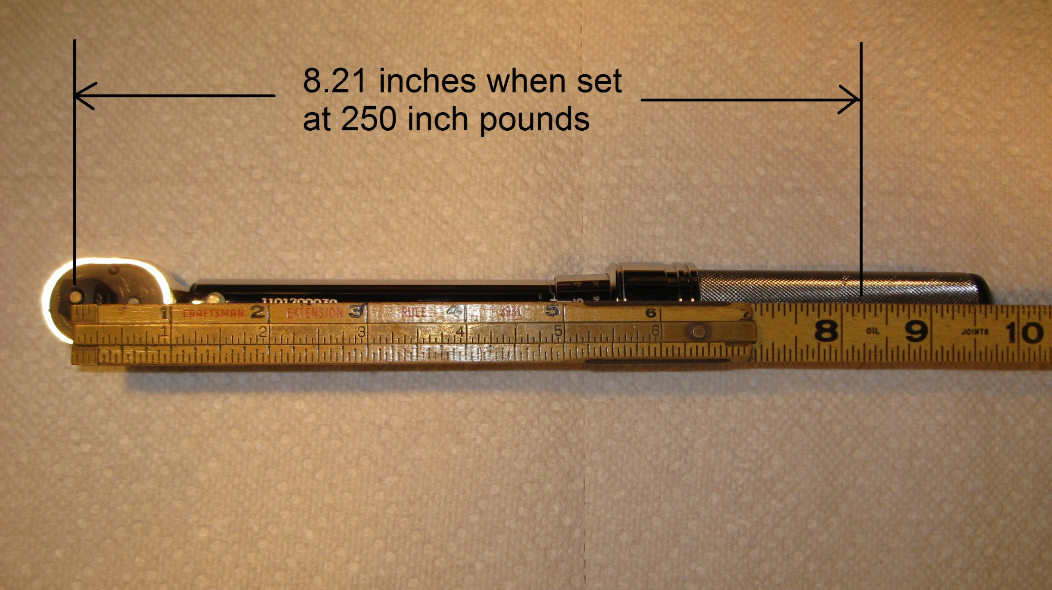

Years ago I installed tapered roller bearings in my 1977 KZ650-C1. It is of the utmost importance that the length of the tool and of the torque wrench be taken into account when calculating the correct torque; if not the torque will be set way too high. One thing that may not be obvious is the fact that the effective length of the torque wrench changes as the wrench is adjusted to different settings. This is shown in the table below. I don’t remember where I found the formula as it has been many years ago. I will say that it worked perfectly for me. Below are the table I used and some pics of the tools I used. Ed

To 650ed: I don't know how it happened, but your post with the torque wrench length chart disappeared.
Rick H.

I screwed up, but it's back now. Ed
