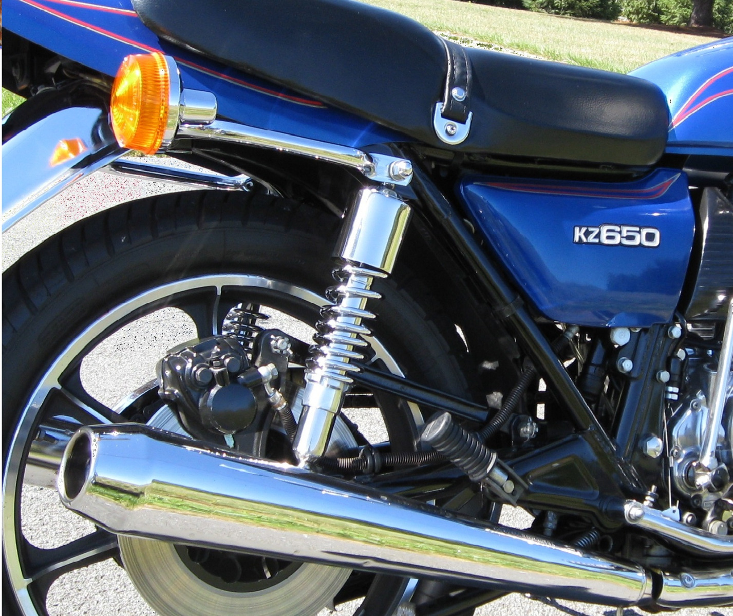

I put Hagons on my KZ650-C1 about 13 years ago. I've put 16,000 miles on them. They still work and look like new! I really like them a LOT! Ed
