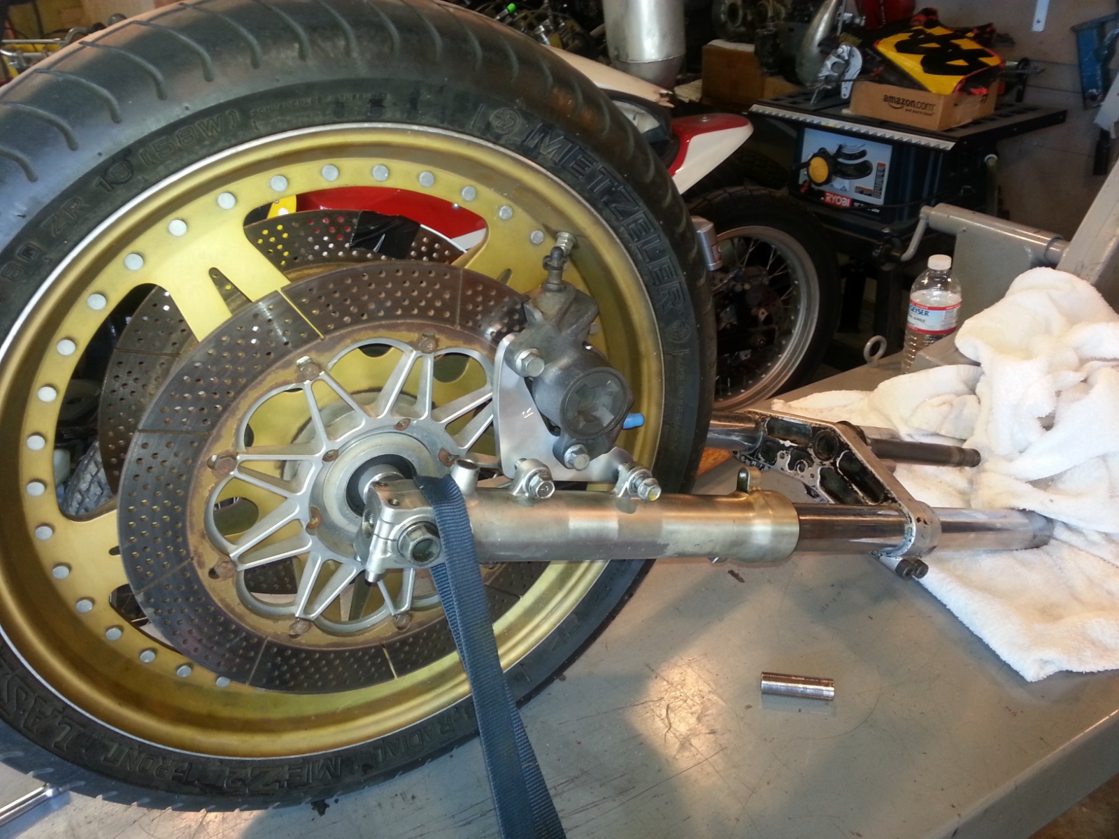

Man that picture above looks freakishly familiar! :laugh:

thats a serious front end there! cast iron rotors, astralites, what calipers are those? what bike did that go on? pics?

DoctoRot wrote: thats a serious front end there! cast iron rotors, astralites, what calipers are those? what bike did that go on? pics?
Thanks Doc. The picture was taken during a fork conversion on my GS1100es. The calipers are Spondon, the wheels are Astralite and the rotors are a Sandy Kosman creation., and forks from a GSXR1100
