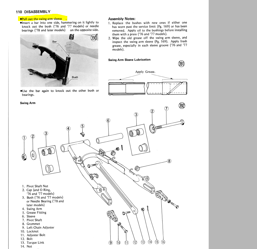

Check below and see what i'm pointing out, the manual just says pull out the sleeve, lol. and it AINT budging!
I will definitely try some heat though, should I just apply it all around the end of the swing arm or just one side? I know there's a grease nipple there as well, should I remove that as well along with trying to get as much grease out as possible?

If you can´t get the sleeve out try to boil the swing arm part in vinegar or citric acid to disolve the rust on the parts.
The heat will expand the parts and support the penetraiting.
