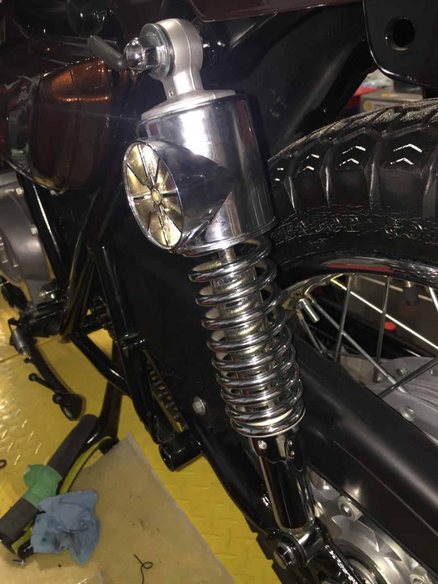

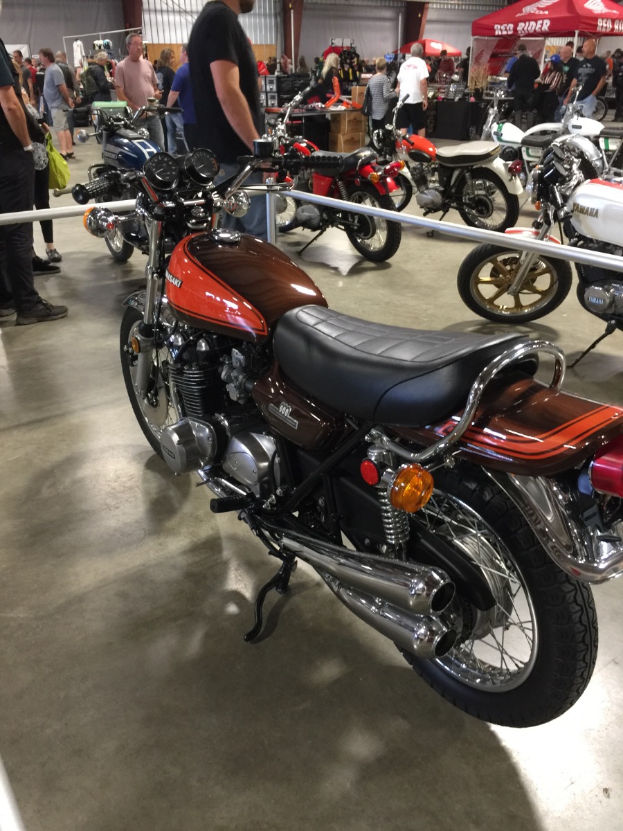

Like you, I have some POP uppers that need re-chroming. I had not found anyone who does plastic but a friend of mine found a company and sent his to OZ for his Z1 restoration (S/N 1006) and they came back looking great but it was expensive. I think he said $205 AUD. Their contact info is: A Class Metal Finishers Pty Ltd, 6 Waddikee Road, Lonsdale, South Australia, 5160. Tel (08) 8383-4331
Here is a photo of one of his re-done and a photo of the restoration...almost complete but not quite. Still needs a few items..note the lack of a rubber on the shifter. The bike is 100% original as from the factory right down to correctly date coded plug wires.

I think I just noticed something else in the photo besides the shifter boot missing. The coil spring appears installed upside down? The OEM coil is tighter wound and slightly smaller on one end, which should face down by adjuster.

I didn't know about the springs, and from the photos I can't tell for sure. He lives about 300 km from me but I have some vapour blasting to do and he has a machine so I plan to visit him soon. Will check the shocks more closely when I see him.

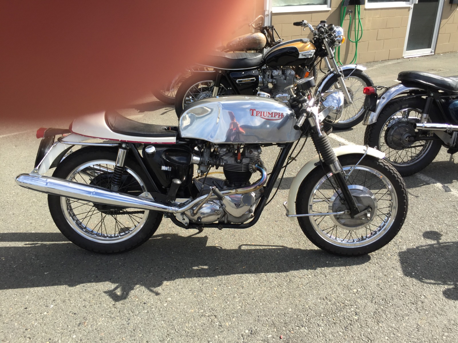

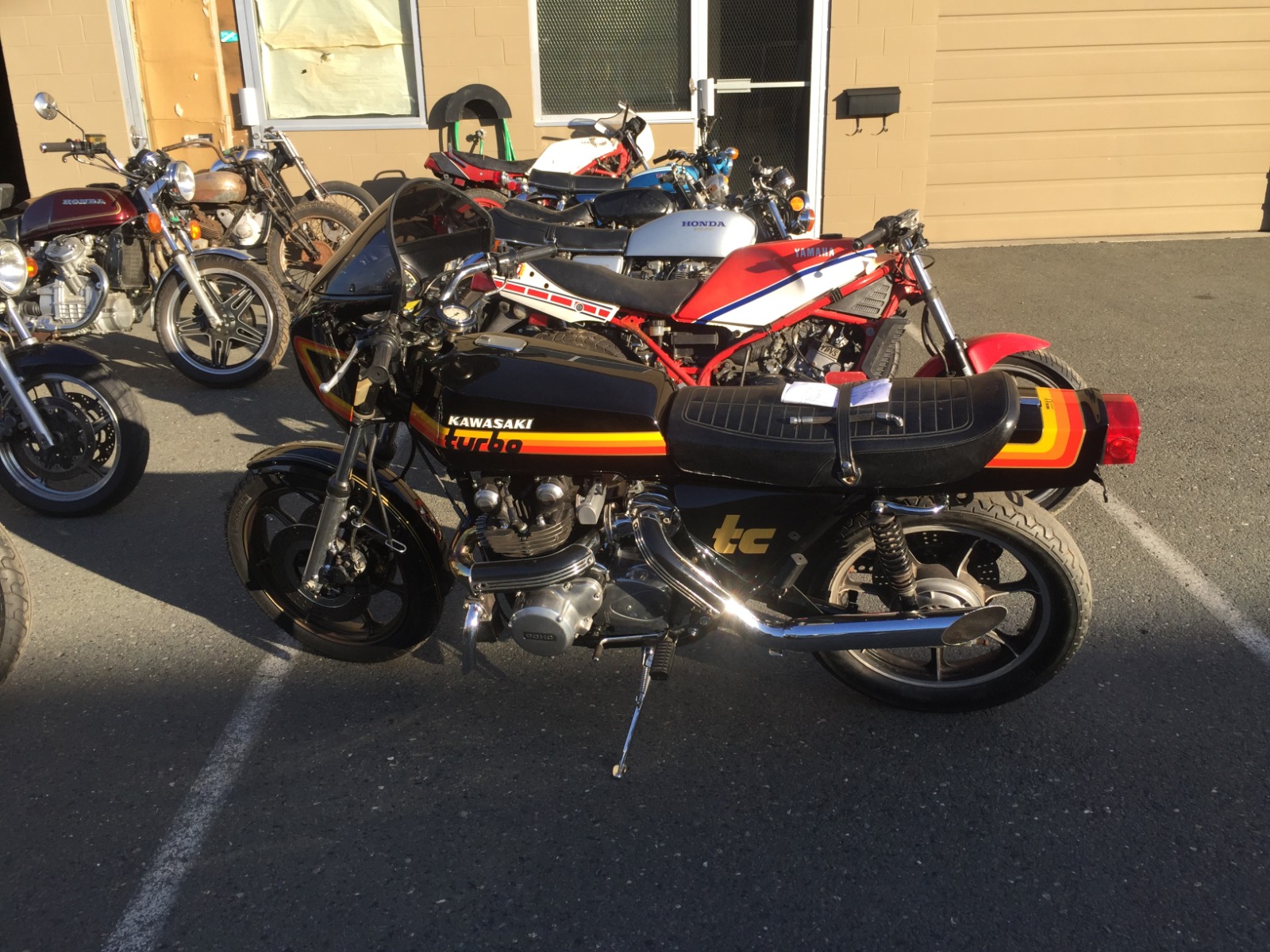

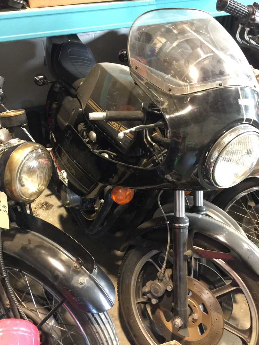

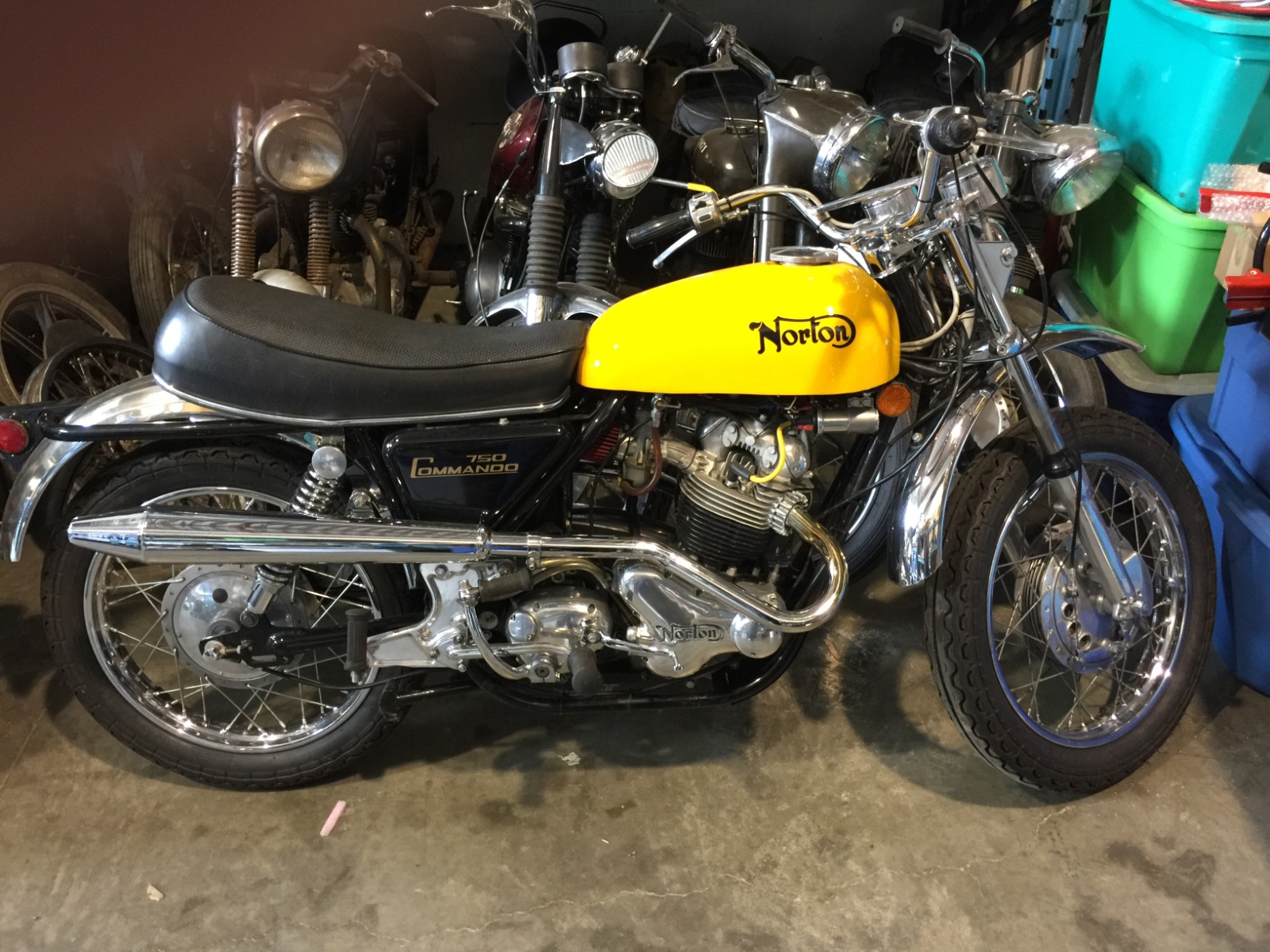

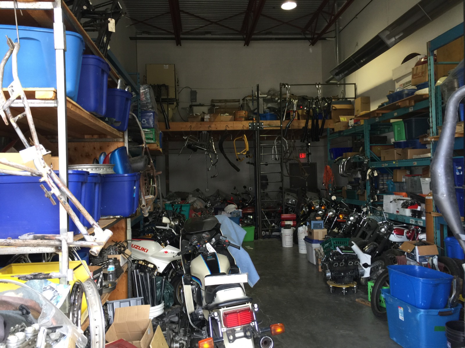

Here are some photos of his "herd".
