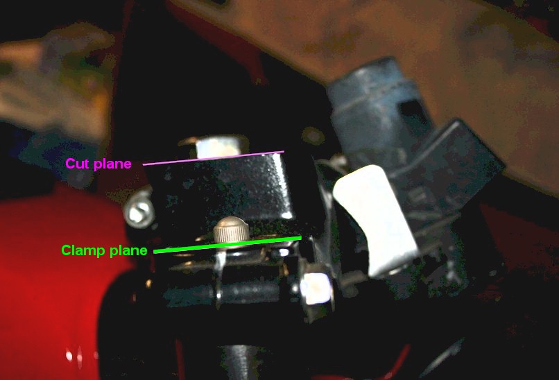

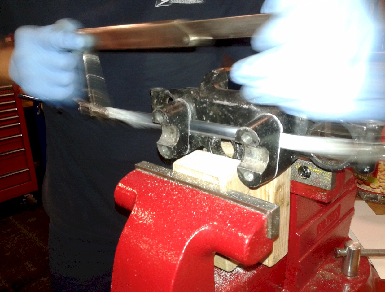

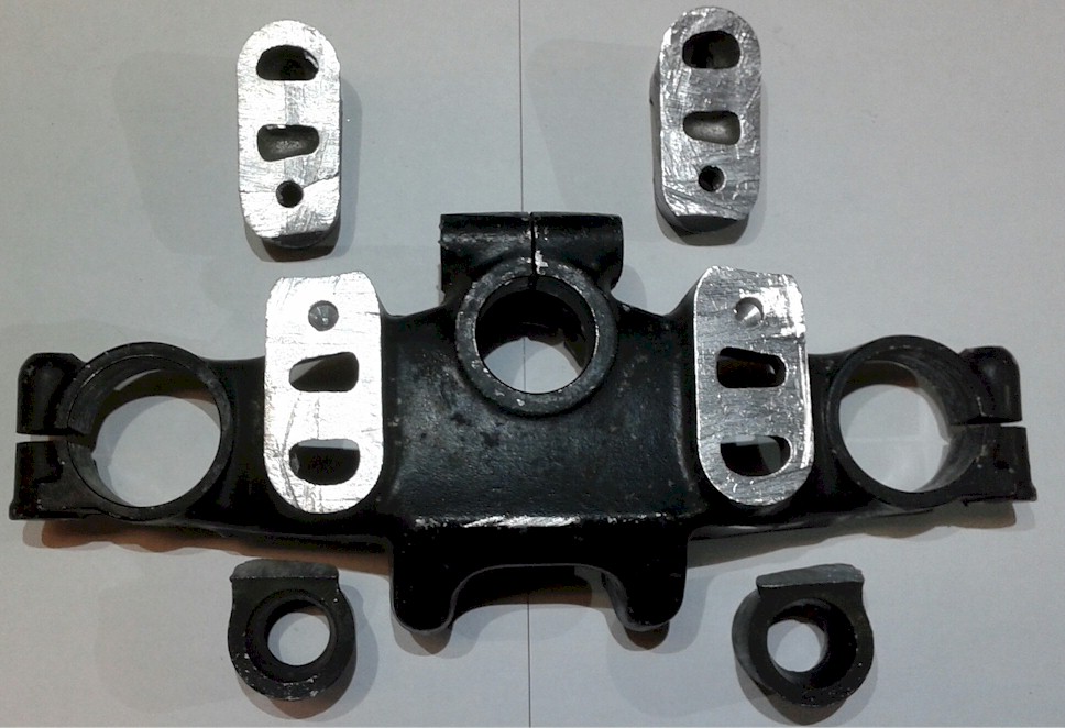

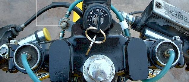

Like Ed said, try the clipons before you change the fork yokes. Or try clubmans. Clubmans are very similar to clipons, but the clipons still require a slightly longer reach and are a bit lower. Be aware, some clubmans are not wide enough to fit properly.
Other than your comfort, there are a few other things to consider and plan for. With clubmans or clipons, you will want to modify the steering stop or you will definitely be hitting the tank with the controls. These old bikes have way more turning ability than they need so limiting the travel doesn't really affect anything but maneuvering in the garage and many modern bikes are like that nowadays. The steering lock can still work fine as long as you limit the steering precisely to allow for it, or you can just shave the steering stop a tiny bit and no one will ever notice.
If you like the clipons and are ready to commit, you can just mill off the bar mounts. But you will need to take it to a good welder who can fill in the holes, cosmetically. Then sand it smooth and paint.
Another option is to use body filler. We tried both. I prefer the welding. My buddy did his with bondo and so far (7 years later) it still looks like new. The results are similar.
I wouldn't cut lower than the top of the big bolt, since that is going to stick up there anyway.
