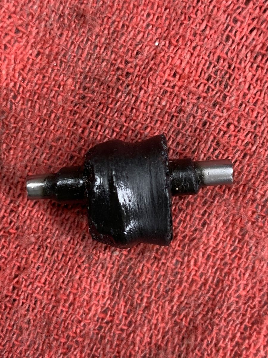

I have most of my 1976 KZ900 A4 apart and have done pretty well with marking pieces so I know where they go. BUT, I I’ve one piece I can’t identify and don’t remember where it went. Help . . . Please! Thanks in advance.

No eBay APP ID and/or Cert ID defined in Kunena configurationThat's a trashed cam chain guide. That was left between engine block and barrels! The other parts made their way to bottom of oil pan. Lot of hard miles on that engine.
They look like this new.
Good Luck with your project.

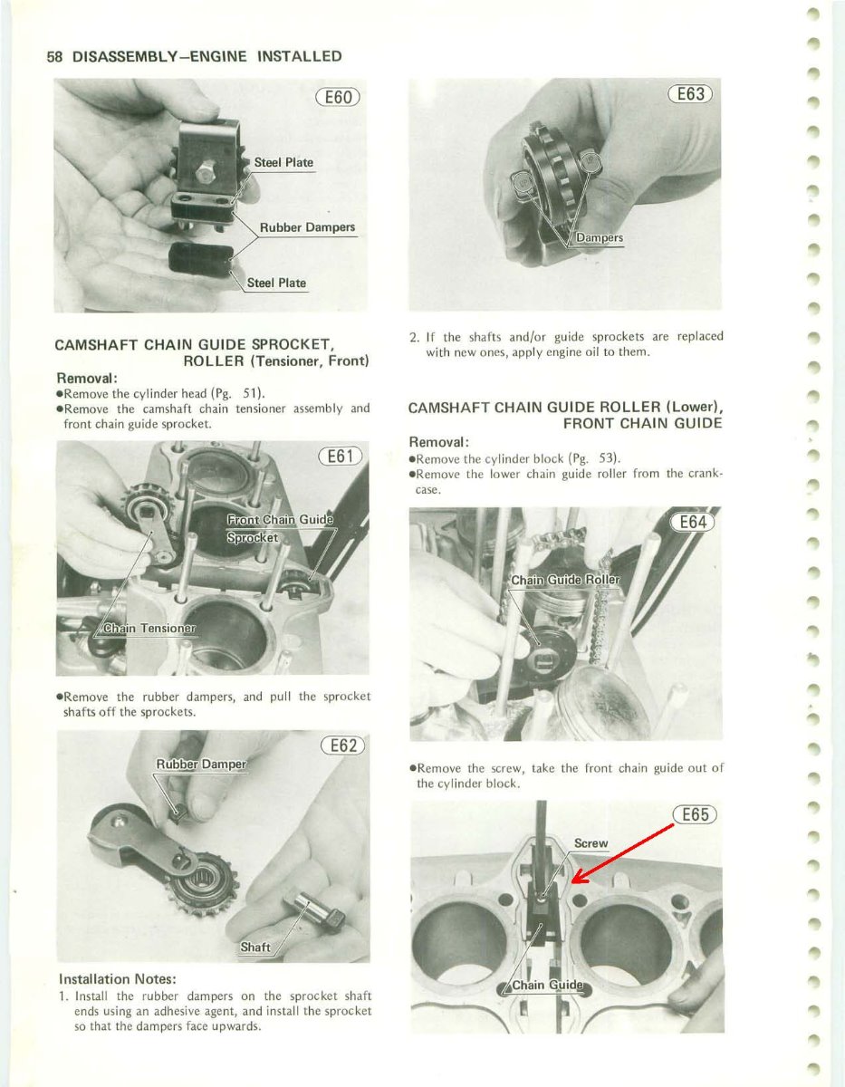

If you take a look in the center hole of the cylinder block you will probably see a #6 screw holding the remaining piece of a chain guide.

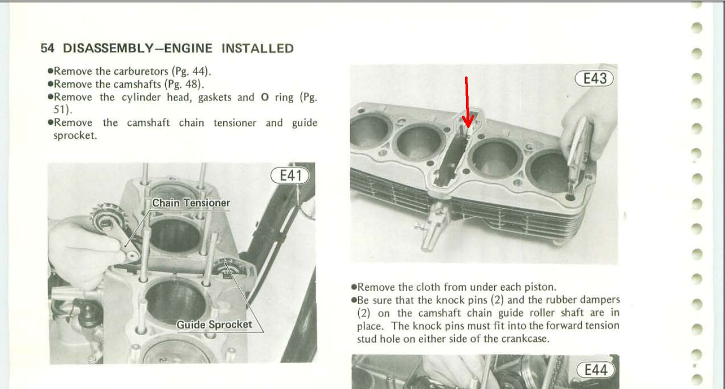

And here are some pics where the chain guide is located.
