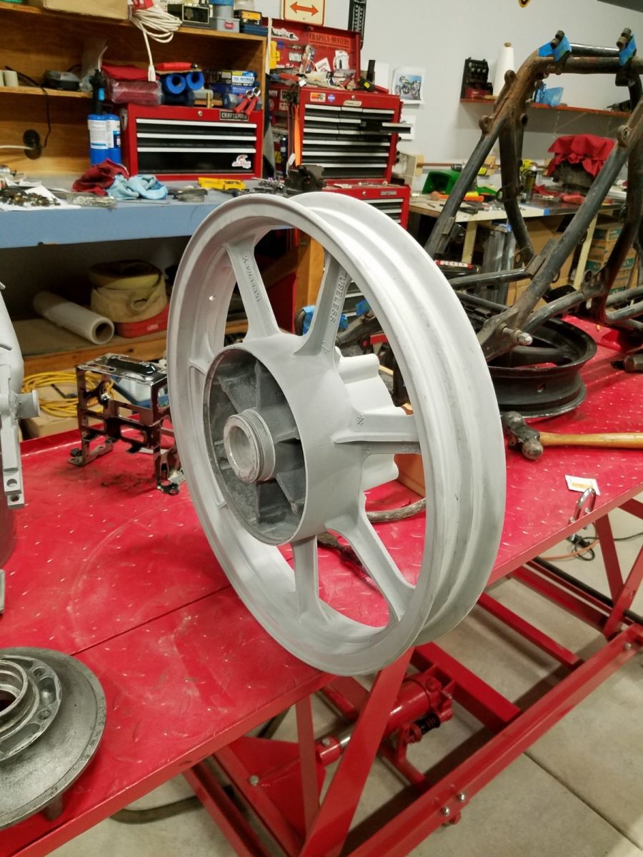

It has been more than several years, so I don't recall exactly, but on the silver areas I probably used wet-dry sandpaper & bronze wool then blue magic or mothers. I'm pretty sure the paint is Duplicolor engine enamel (without primer). The original stock paint is pretty tough, so I just scuffed it up & hit the corners using a dremel. I used grease to mask the silver part of the spokes & around the drum. The rear wheel still looks pretty good, but the front needs to be repainted.

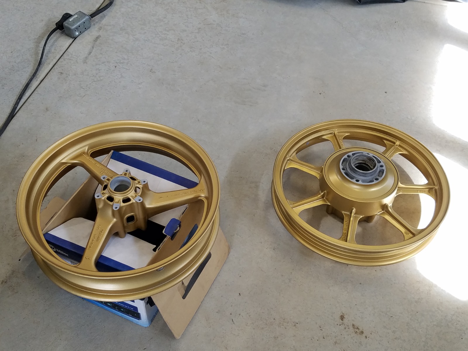

I got a blast cabinet from a friend for free, but it took a bit of money to get it working. The results are awesome! I am using 80 grit glass bead for media. I elected to go solid gold to save the expense of masking or more than one color. The wheels I had powder coated.

25 Oct 2019 09:16
Big improvement. What did the powder coat set you back?

I also had the rear swing arm and brake stay coated in a metallic silver, in the same order. The lot was around $250, but got a 24 hour turn around.
