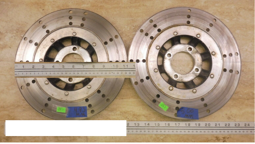

There are two sizes of the thinner dual disk rotors If you got the dual disk from a KZ650 they are a smaller diameter than the kz1000 dual disk that Steell was referring to. the KZ650C and KZ650D had different fork lowers so the brake caliper was mounted lower on the fork tube to run a smaller disk.
- Thanks: 2830
Re: kz650LTD dual front brake conversion
25 Sep 2019 17:47
The KZ650B and KZ650E (LTD) models had front rotors with a swept area of 250mm and a thickness of 6.9-7.1mm. The KZ650C, D, and F models had front rotors with a swept area of 231mm and a thickness of 4.9-5.1mm. Ed

No eBay APP ID and/or Cert ID defined in Kunena configurationSo these won't work?

I don't see why not. Did you ask about the diameter. I have a pair off a later KZ1000 that work well. Slightly different but no problems.

I already bought them; I'd measure them for real, but they are in my parent's basement with the rest of my parts. I didn't know diameter was an issue when I bought them. They are approximately 285mm outer diameter according to that picture of them with the ruler and some MS paint skills.

They look to be the same size as mine.

Assuming the numbers on the blue tag show the rotor thickness it looks like they are from a dual disk setup (that’s a good thing). The single disk versions were thicker and heavier. Keep in mind that the diameters shown in my previous posting show swept area not outside dimensions. Ed

How would I calculate swept area?
Also I'm getting a bad feeling that I didn't get the right ones because the diameter of the rotor currently on there seems bigger. I cant do an exact measurement with it on the bike still, but it seems like half an inch bigger.

The outside diameter of the 1977 KZ650-C1 front rotors is 10 15/16" Ed

If they are the smaller disk size your caliper may not be situated over the disk properly reducing your pad contact area. This is true with the stock caliper, not sure with the gpz calipers. The kz650 dual disks look identical to the kz1000 dual disks but they are slightly smaller.
