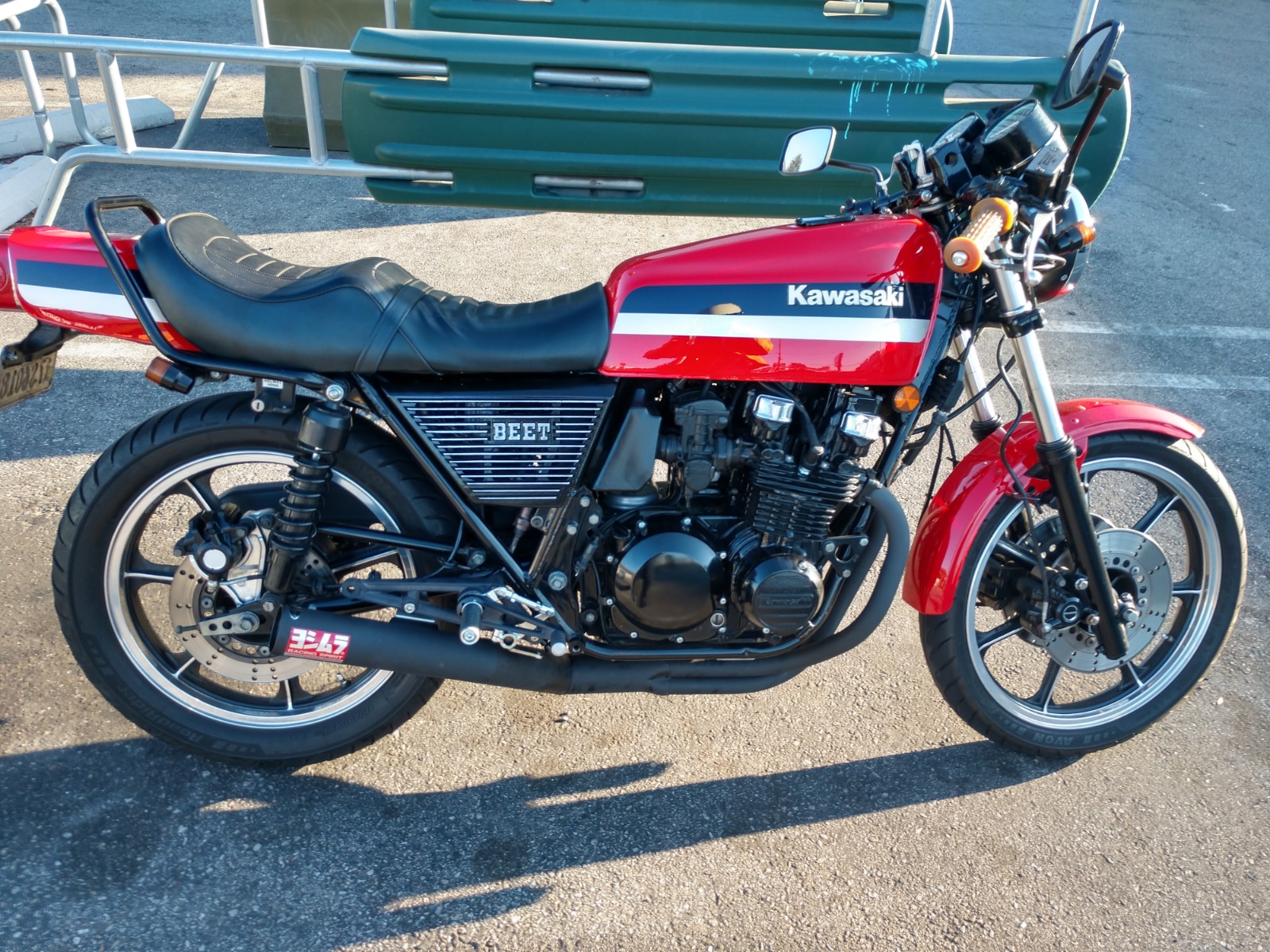

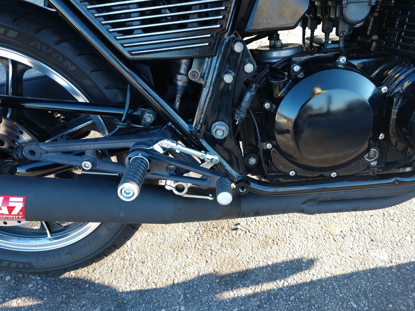

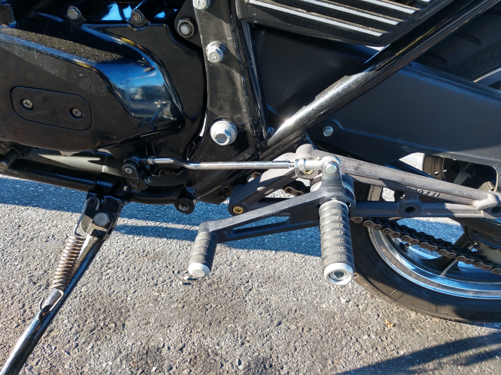

Hey Caleator, quick question looking at the close up of the RH side of your bike -- the part that mounts on the axis that connects the rearset lever to the master cylinder - it has a piece that juts off at an odd angle along the bottom - is there where the return spring mounts? Didn't see a spring in your photo.
Thanks again.
Thanks again.
- Caleator
- Posts: 111
Re: Anyone have exp w/ Tarozzi rearsets for 81 gpz550?
28 Jan 2020 18:15 - 28 Jan 2020 18:16
Yeah, it has a hole in it. and it is a VERY weird angle, and honestly poor design choice. it limits the angles you can set the brake lever.
You have to stretch the spring a fair amount to get it to fit. I somehow got it on the first try.
I suggest bleeding your brake before putting it on, in case finding a good angle for the brake lever is difficult.
I didn't have the spring on or the passenger pegs on in the pictures, but I do now
