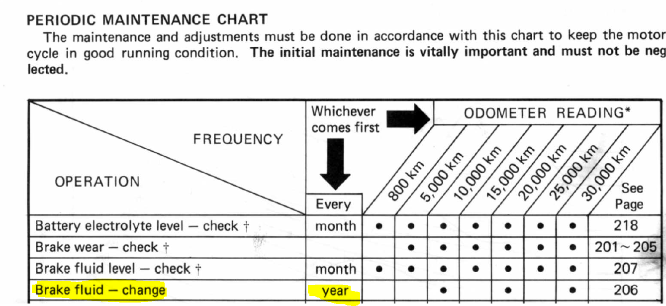

Kawasaki calls for changing brake fluid every 10k miles or annually, whichever comes sooner. This is a little excessive but the point being brake fluid starts to coagulate and coat the inside of the lines, master, and the inside of the caliper with grunge that resembles jello so it's important to change it regularly. By the time that little port is plugged it's too late. A full system tear down is in order. Clean out the sludge and change the lines since they get soft with time and there is no way to clean them out anyway. Money well spent. If the caliper pistons are pitted they will need to be changed, and it's wise to change the seals too. Use OEM parts where ever possible. K&L brake system parts are junk so stay clear of them unless there is no other option.

04 Sep 2019 15:00Nessism wrote: Kawasaki calls for changing brake fluid every 10k miles or annually, whichever comes sooner. This is a little excessive but the point being brake fluid starts to coagulate and coat the inside of the lines, master, and the inside of the caliper with grunge that resembles jello so it's important to change it regularly. By the time that little port is plugged it's too late. A full system tear down is in order. Clean out the sludge and change the lines since they get soft with time and there is no way to clean them out anyway. Money well spent. If the caliper pistons are pitted they will need to be changed, and it's wise to change the seals too. Use OEM parts where ever possible. K&L brake system parts are junk so stay clear of them unless there is no other option.
Good luck
Actually, that is 10,000 kilometers, not miles. More like 6,500 or 6,600 miles.
