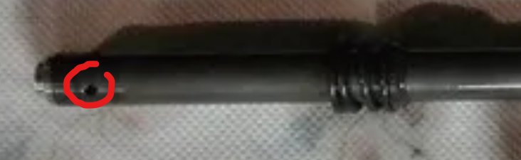

Been a while since this thread was active but I'm finally getting around to sorting out some extensions for the restomod - it's falling into the corners a little too well...
@zed1015 I have been wondering about the hole in the bottom of the damper rod - the horizontal one that is covered by the caps at the bottom of the forks. Normally the caps sit over this hole restricting flow when the forks compress. With the extensions the hole will be unrestricted and more oil can flow. Is this a problem or am I overthinking things again? I was thinking of machining longer bottom caps for the damper rods to keep the flow restricted.
Don't have a decent picture but found this on another forum.

Hey Calum are you switching to USD ?
- calum
- Posts: 1144
- Thanks: 415
Re: Lengthen forks for zx to kz swap
28 May 2025 16:14
No, it's for the ZRX forks but the process is the same. The forks just need to be a little bit longer so the bike is a bit more stable. It's pretty tippy at the moment - but only really at low speeds so I suppose I could just go faster!
