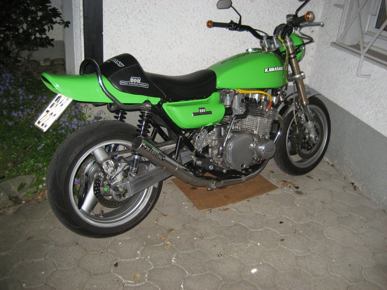

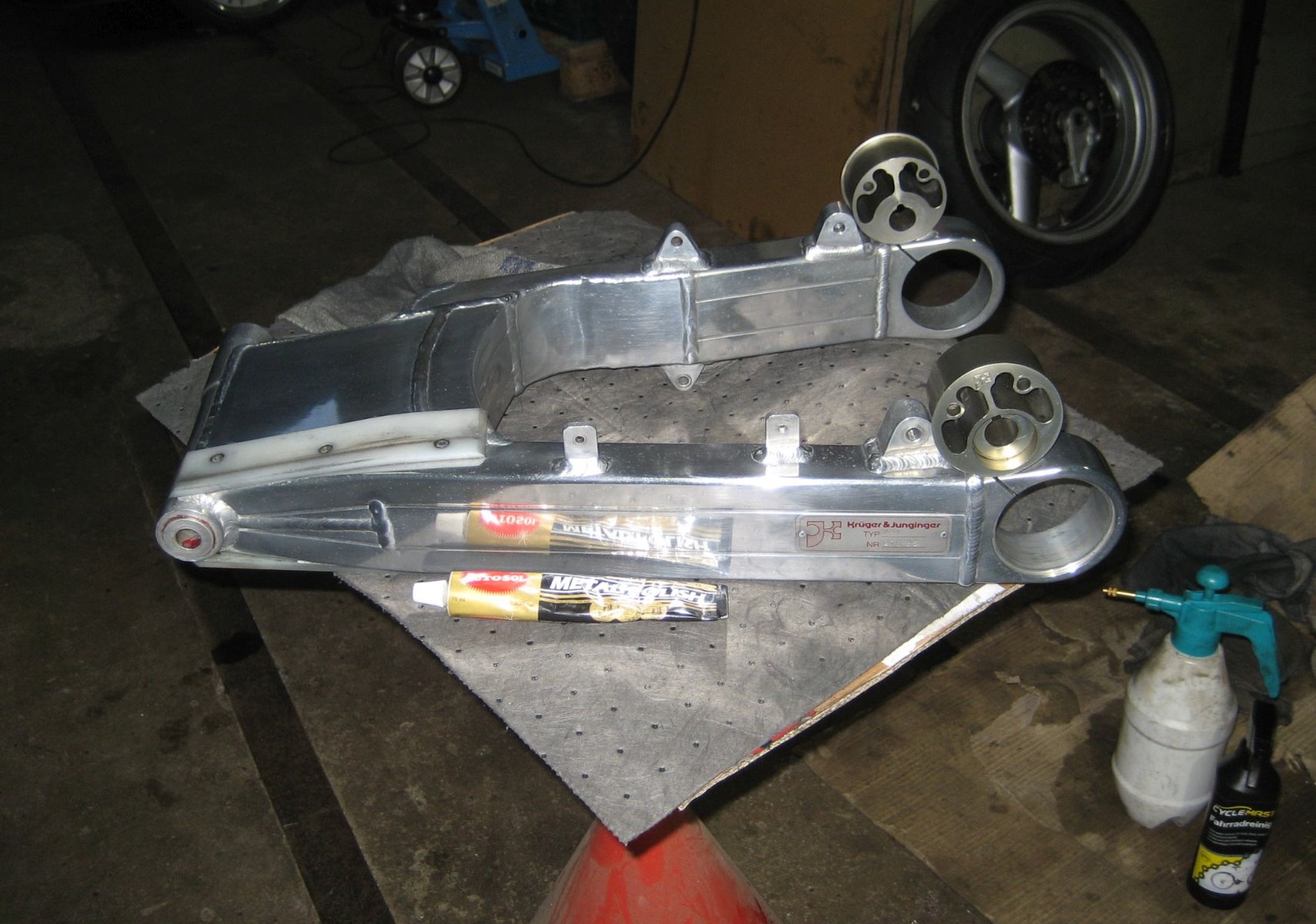

I have a Krüger and Junginger aluminum exentric swingarm since 1995 in my Frame. It´s made for the eternity.
