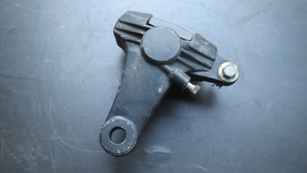

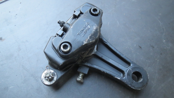

I believe those are calipers, not master cylinders.

Yeah, those are the rear calipers. I need the master cylinder that hooks to the brake pedal

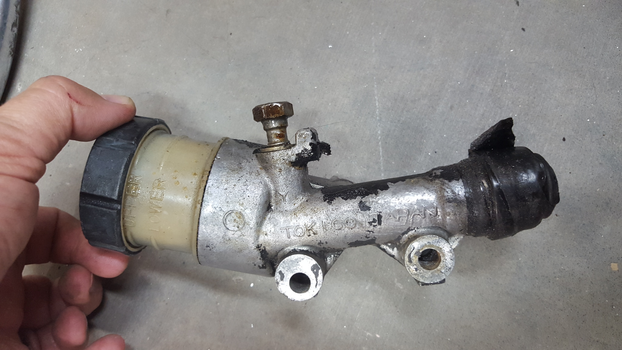

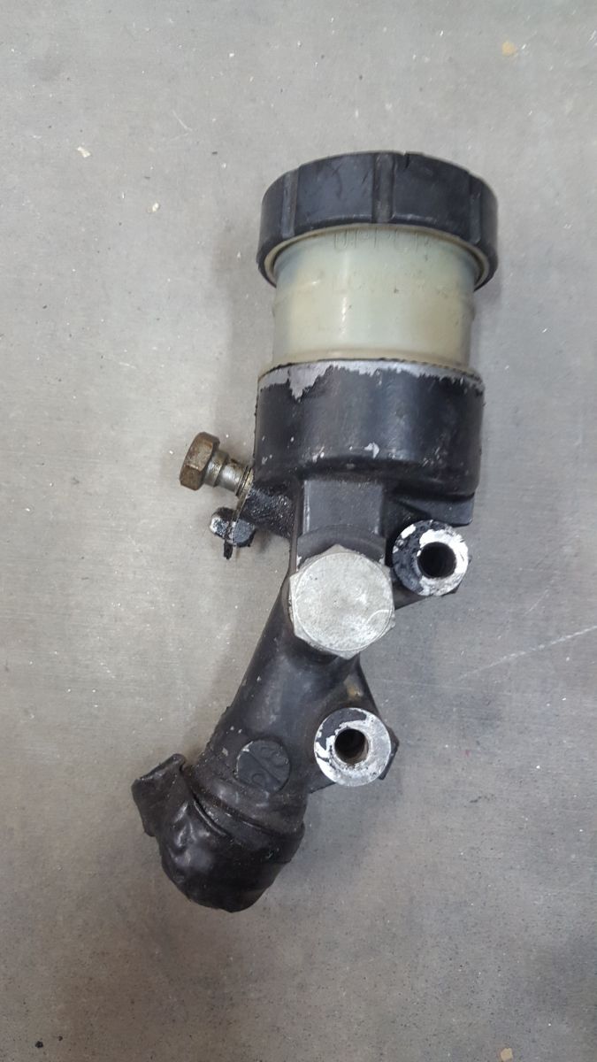

Member kaw-a-holic offers a 77 KZ1000a1 rear master cylinder a long time ago here, give it a try and PM him.
kzrider.com/forum/5-chassis/602655-rear-...r-rebuild-kit#728995

I think you will be looking for a needle in a haystack trying to find a new NOS rear master cylinder. You may be better off trying to figure out why yours is leaking after a rebuild. Was the inside bore messed up at all? You may want to try to rebuild it again and make sure to hone it out if you do. Otherwise your next best option might be to find a good used one to replace the original.

I did hone the cylinder out and it was in good shape inside. I bought the aftermarket rebuild kit and I think it's just best to use the OEM so I ordered brand new OEM from Partzilla
