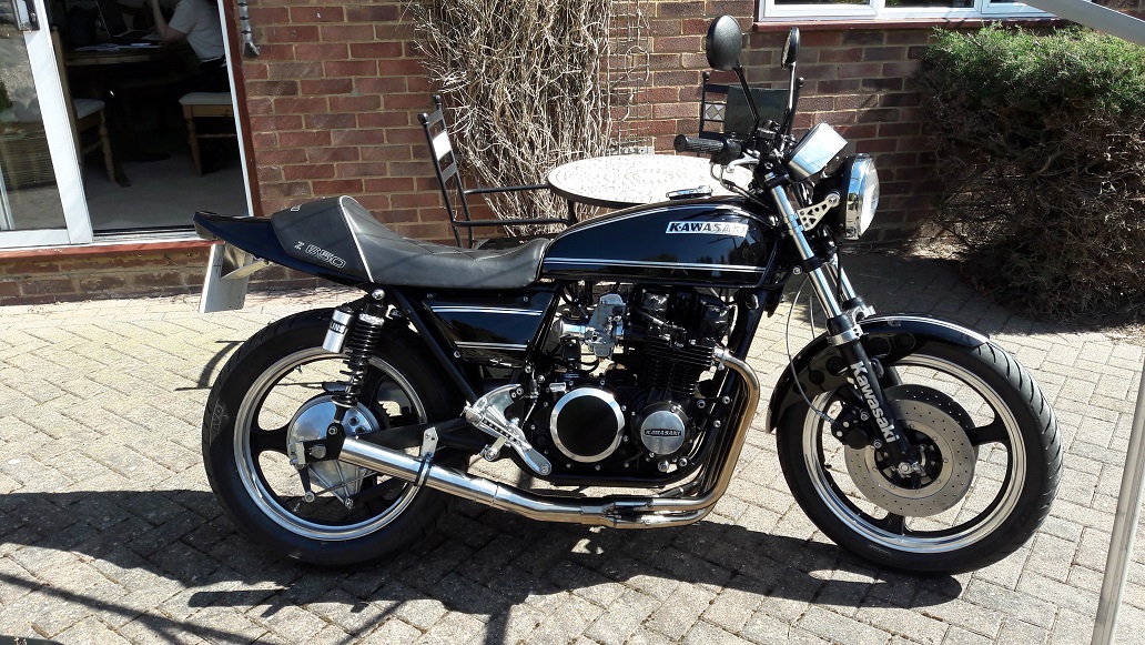

The wheels below are actually magnesium race wheels of a 900 in the mid 70's made by a small UK company called CMA. The story goes that the company wasn't around very long as the owner was killed when he was repairing a set with oxy and they exploded. Rick is right Magnesium burns at a phenomenal rate.
The following user(s) said Thank You: TexasKZ
