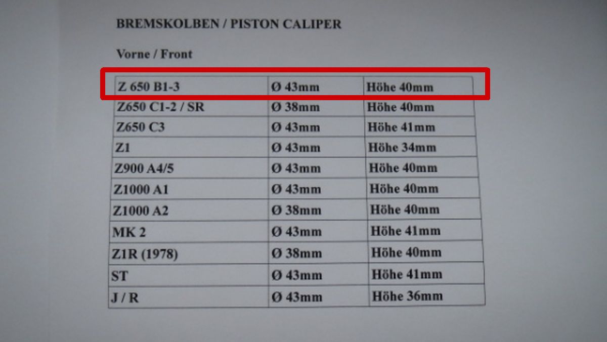

You need to identify EXACTLY which model bike you own and which model 1977 KZ650 the parts are from. Some models came with dual front disks and some did not. Aside from the dual disk models having 2 sets of rotors and calipers here are other differences between the single and dual disk models that may effect your decision. Ed

The 81 KZ650-CSR caliper fork mount is completely different than the 77. see diagram drawings at Partzilla. I have no idea if the swap will work, but probably not. The csr is almost a completely different motorcycle than a 77 model & just about everything is different.
If the master cylinder is for a single disk, then it should work fine, but depending upon which mc it is, repair parts might be hard to come by.
