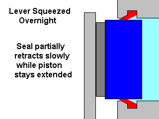

Binding caliper pistons are relatively common after a rebuild, particularly if you used aftermarket seals like K&L brand. Try tying back the lever to the bars after pumping up the brakes and squeezing as hard as you can. The constant pressure in the system will allow the caliper pistons to creep out towards the disc and reduce the amount of fluid needed to get the pads in contact with the disc. If that fails, and you used aftermarket seals, I'd order OEM seals and rebuild again.

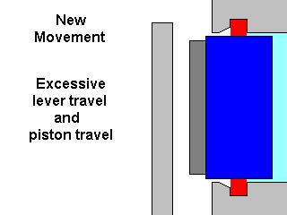

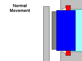

I agree with Ed. Apply the brakes, wrap some rubber bands around the lever to hold it with a decent pressure, but not excessive.. Let it sit overnight and check it in the morning.
As long as the problem is not air bubbles, that trick should work.
Forgive me for posting these animated gifs. It took a long time to make them and I don't get to post them very often.

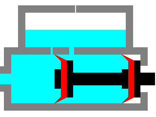

Normal brake master-cylinder operation.
Master-cylinder during system-bleeding.
