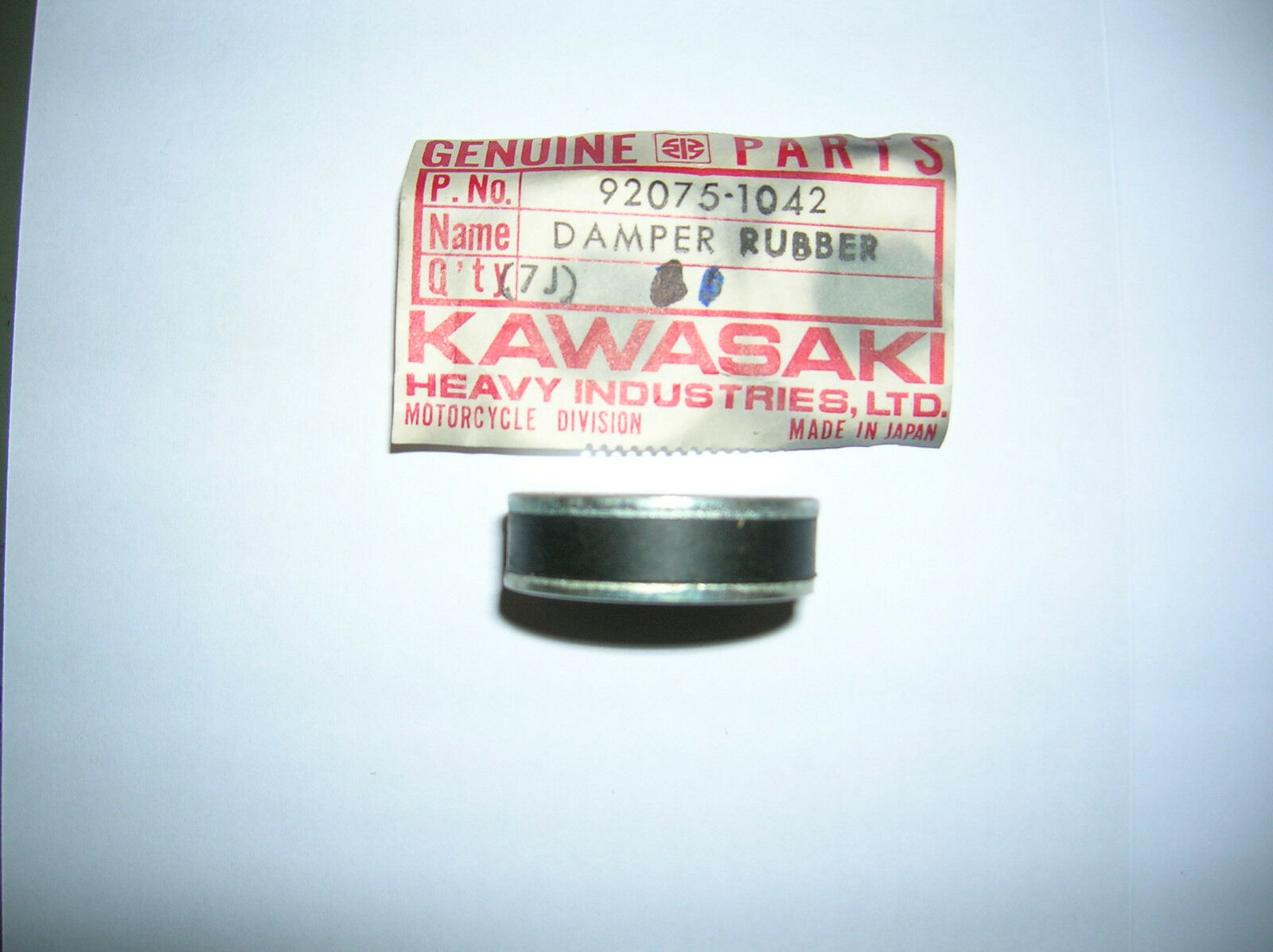

17 Mar 2022 13:56John, do you still have those 4x 92075-1042?Hi, John from NY here. If you still need those Kawasaki exhaust dampers I have 4 NOS for you. 914-260-5656,
John

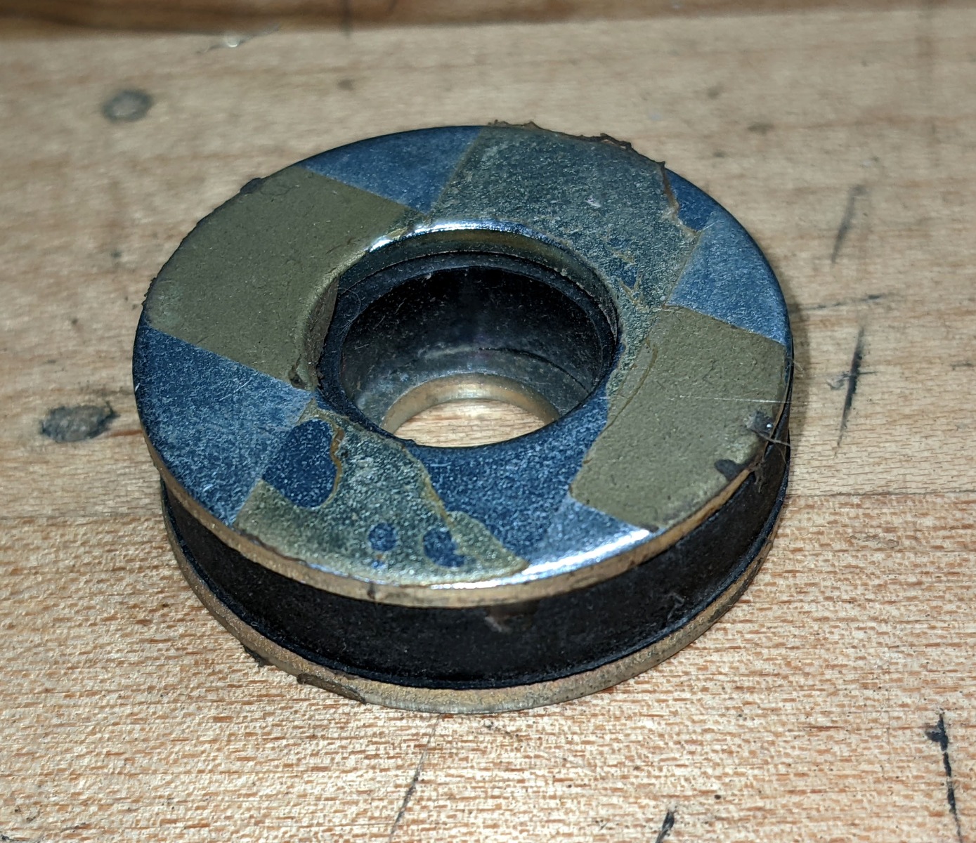

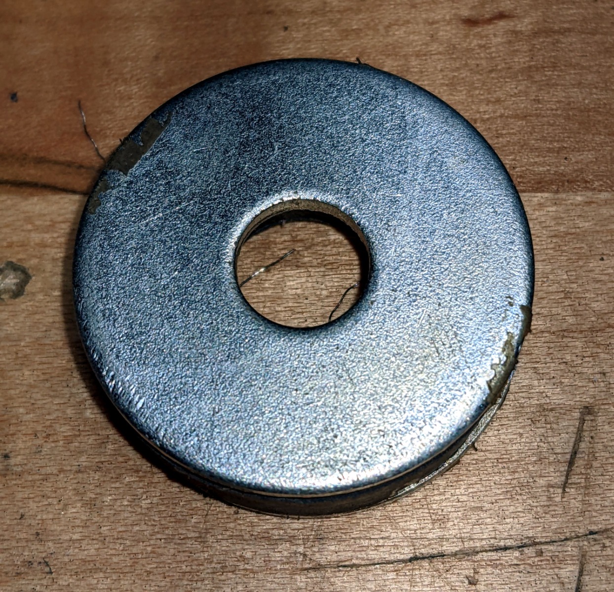

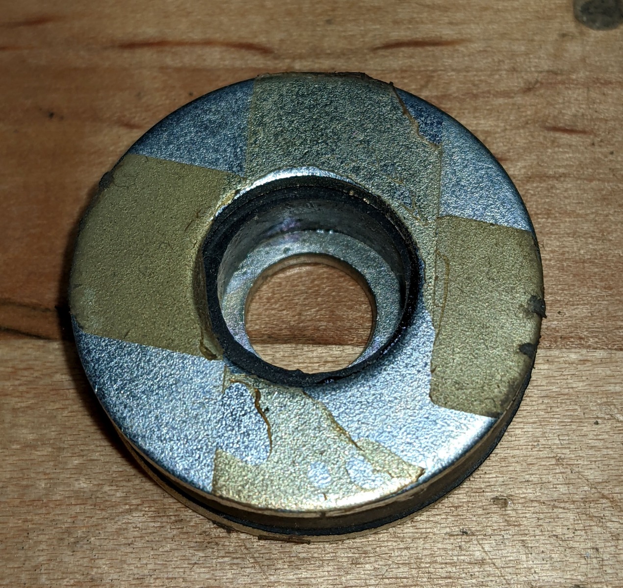

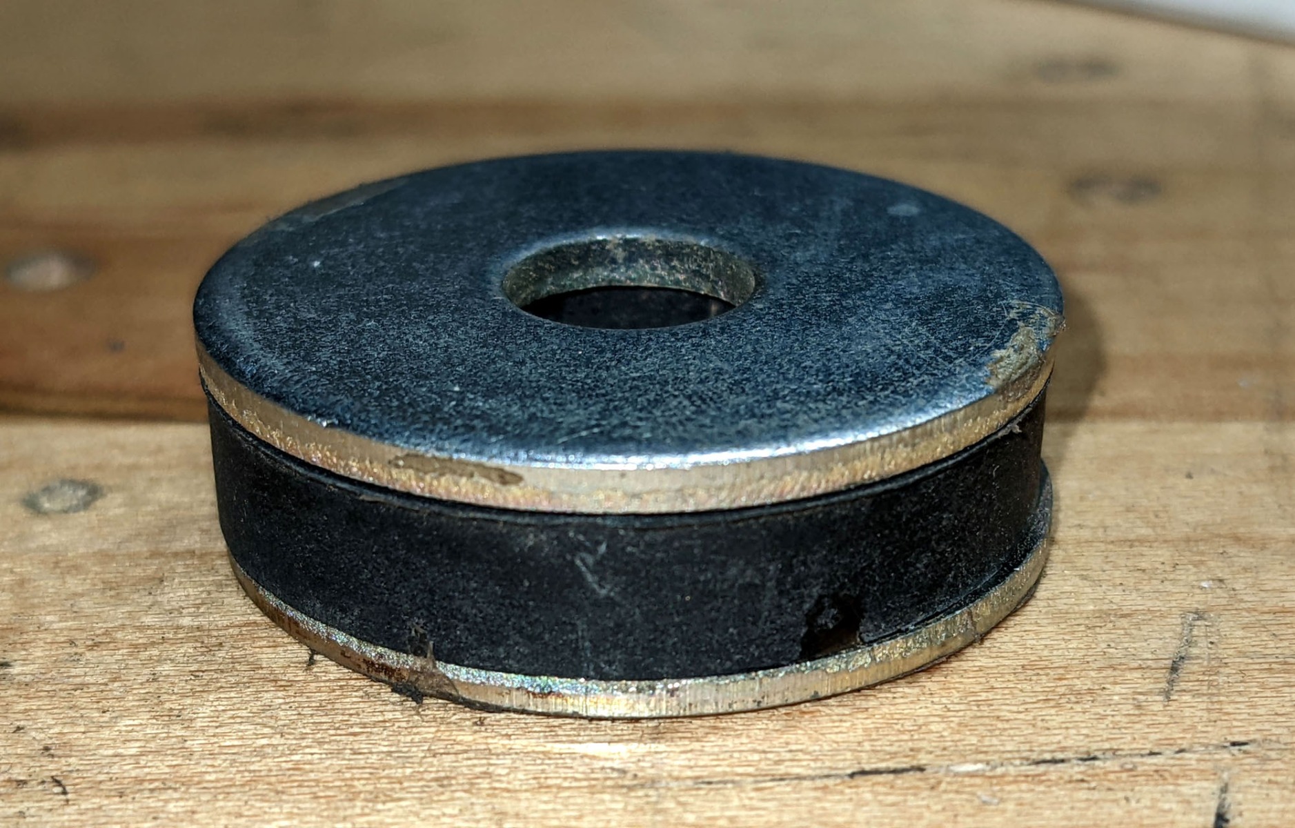

22 Mar 2022 19:30
I eventually managed to find it. It's basically two washers glued on to a rubber disk. The OD of the disk and washers is pretty much the same, but one washer has an inside diameter smaller than the rubber ID, and one washer has an ID that is slightly larger than the rubber ID.
Here are the dimensions:
OD: 30.3 mm
Overall thickness: 9.33 mm
Small washer ID: 8.72 mm
Large washer ID: 14.14 mm
Rubber ID: 12.4 mm
Thickness of rubber ring alone: 5.65 mm

23 Mar 2022 05:40
DOHC, exactly what I was looking for!
A thousand thanks!!!
