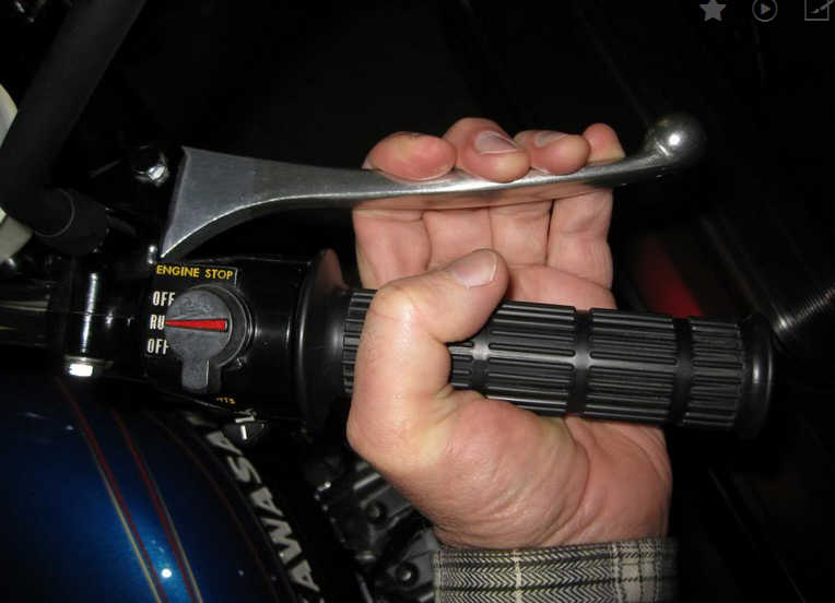

It does sound like there's air in the brake lines. I'm the original owner of my 1977 KZ650-C1. I've never rebuilt the brake calipers at all, but I change the brake fluid every 2 - 3 years, and I have replaced the original pads twice in 61,000+ miles. As far as I am concerned, the KZ brakes are top notch. The pic below shows me squeezing the brake lever very tight, so you can see how far it travels toward the handlebars. If your brake lever travels much further I'm sure there is air in the brake lines. Ed

Thanks for this photo.
Seems it was just my imagination. One of my neighbor's sons (live abou t30 miles away) is a tech who specializes in vintage bikes. He said my brake lever and pressure are fine. Thankfully!!!
