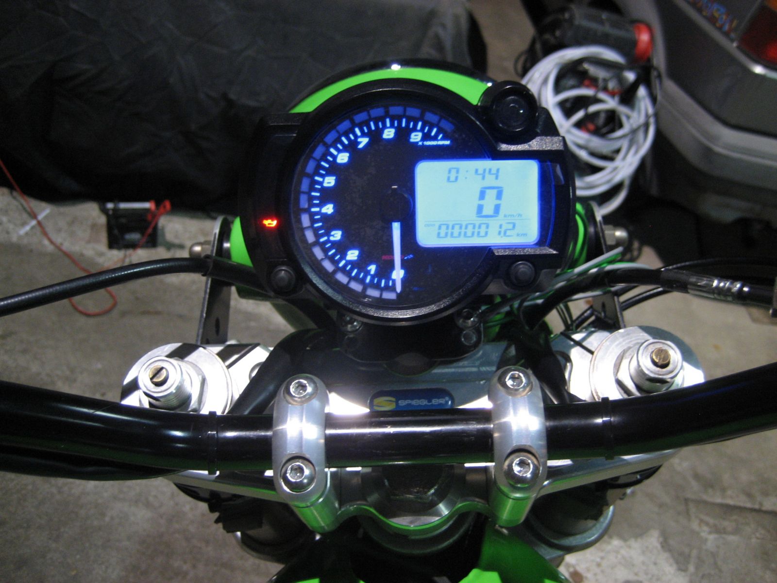

Does the Honda speedo take its reading from the front wheel like KZs with electronic speedo? If so, does the drive on the wheel look like it will accept the KZ drive?

Thanks for the idea, but it's unfortunately not run mechanically off the front wheel.

Sounds like an easy solution. I was hoping to do the same, but it's a speed sensor on the CBR, not a mechanical drive.

By nixon: Sounds like an easy solution. I was hoping to do the same, but it's a speed sensor on the CBR, not a mechanical drive.
You're probably going to have to get a digital speedometer then add a speed sensor to the front wheel or whatever sensor they use. From the diagram, the Honda seems to have the speedo sensor located on the crankcase. Trying to adapt a KZ speedo drive to the Honda front wheel is probably near impossible.

That was my thought as well unfortunately. Thanks for the input. I'll search for a digital speedo with the vintage appeal.
