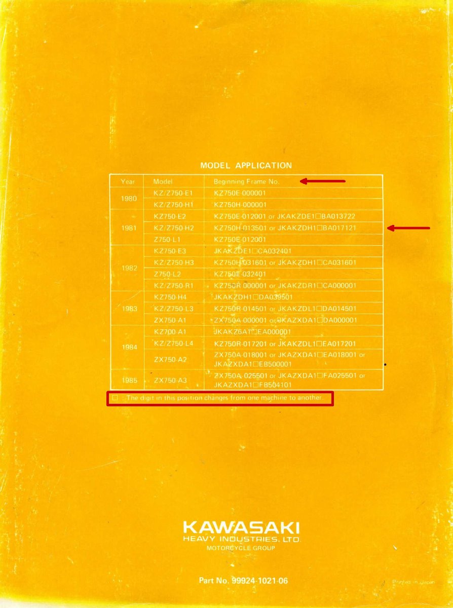

Looks like some PO put an new (wrong) reproduction sticker on the head tube.
The stamped VIN is the right VIN

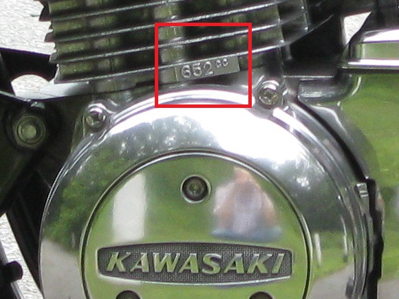

Some states make use of the engine number for ID and not the frame number.
From what you have posted your frame began as a 1981 KZ650 H1, but has had an engine from a KZ750 installed at some point.
