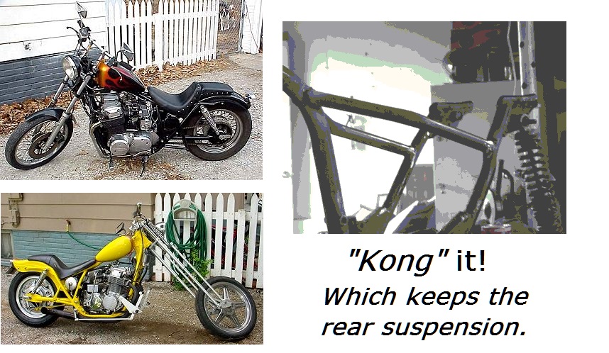

- Posts: 18567
- Thanks: 2103
Last edit: 10 May 2019 12:50 by Patton.
